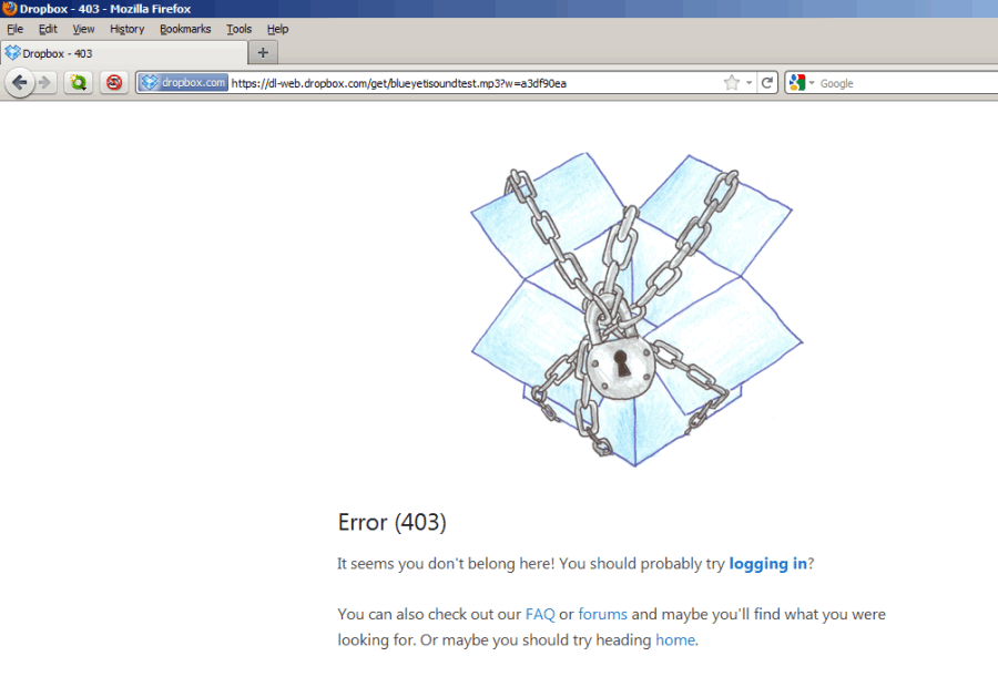

Here is a sample of the hiss, recorded in a quiet room several feet away from the computer on a solid surface: https://dl-web.dropbox.com/get/blueyetisoundtest.mp3?w=a3df90ea
That link gives a 403 error …

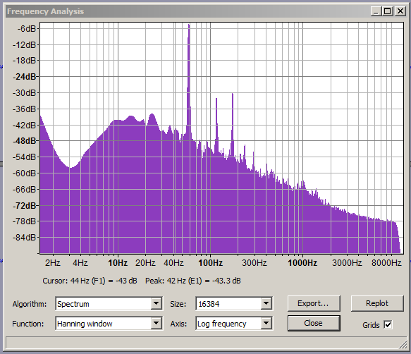

The most conspicuous noise I can hear is mains hum, (rather than hiss), which shows up as clear peaks on the frequency analysis …
You could try recording on battery power, rather than with the laptop connected to the mains electricity.

Given the spectrum picture above, did you try recording on top of your old tube-type TV set, microwave oven, or other electrically noisy appliance? This is sometimes a little magic but appliances that generate radiation (and they’re surprisingly common) can get into a recording with buzz and hum. Sometimes laptop computers sitting atop a “real” computer can hear the large, powerful hard drive spinning up.
Did you or neighbors get anything new? I can tell when the old refrigerator next door-east starts up because my FM reception takes a dive.
I can destroy any recording by making a cellphone call next to the computer.
