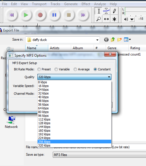

Below is the MP3 options menu in Audacity 1.3 where you set the bitrate when saving as MP3, (use 256Kbs or 320Kbs for high quality sound).
If you are using Audacity 1.2 you can alter the MP3 bit rate by clicking on “Edit”, “Preferences” (at bottom of drop down menu), then “File Formats”. The “MP3 export setup” should then be visible, again adjust the bit rate to 256 or 320Kbs for high quality*, click on “OK” after you have changed the bit rate. (* you could try saving at lower bit rates to see if the results are audibly acceptable, the lower the bit rate the smaller the file size and lower the quality of the sound ).

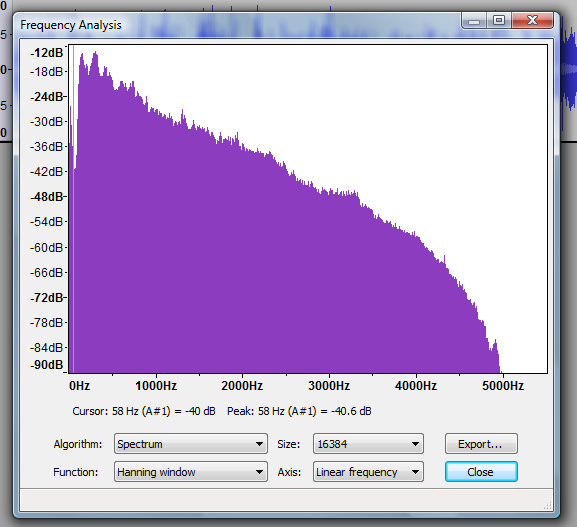

I downloaded a “popular“ (Bill Phillips) webcast from Blogtalkradio and analysed its spectrum …
The moral: don’t send Blogtalkradio audio frequencies above 5KHz, as they will be only be reproduced as sizzle noise.
