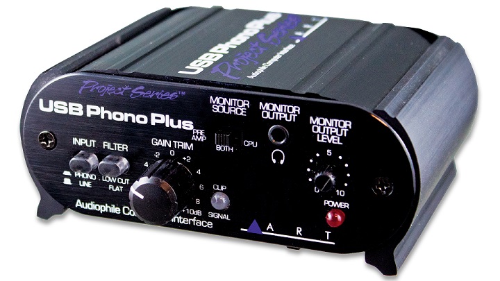

Have a look at this device from ARTcessories - USB Phono Plus:
note that gain comtrol know in the picture
I have the ARTcessories pre-amp that I used connected to my Edirol UA-1EX from my turntable. build quality and sound quality is excellent. They didn’t make this integrated pre-amp/USB sound card at the time I was buying - had they done so I almost certainly would have bought one.
