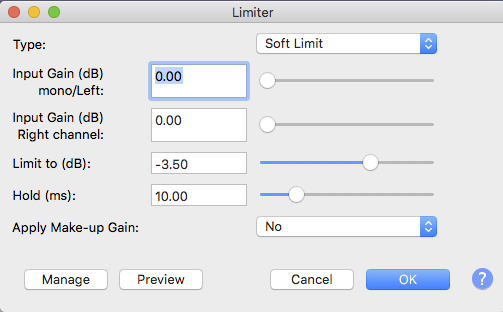

Let’s do volume.
Effect > Loudness Normalization > RMS > -20dB > OK.
Effect > Limiter
Note you have to use Soft Limiter after Loudness Normalization. It will turn into a ball of distortion if you don’t.
