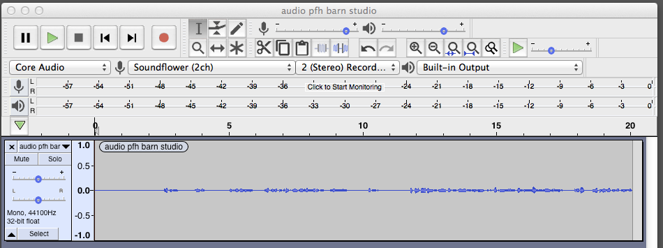

Where did the volume go?
It’s not hard to set this. While you’re announcing, the bouncing sound meter should just/occasionally tip into the yellow region.
When you get done reading, the blue waves tips should occasionally reach up (and down) to 0.5.
Open the barn test. The blue waves aren’t even close to being loud (tall) enough.
As before, your job is to make your voice louder than the noise, which in this case, is mostly coming from the microphone itself. All electronics make a little noise. Higher-end microphones and recording systems promote the quiet operation of their products—usually on the front page.
The barn test will not pass noise without help.
