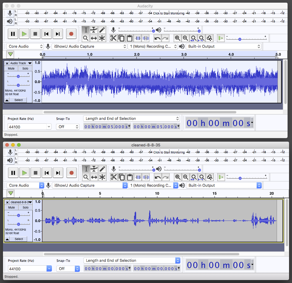

I started getting an odd issue from yesterday which I never faced. Whenever I open a file, and then open another file, what I see is that Audacity plays the recent file I opened and when I go back to the first file that file can’t be played.

Audacity will only play the track(s) in one window,
but you can have multiple tracks in one window playing at the same time.

I’ve multiple windows files open in them, but whenever I play the most recent open file, Audacity plays it. However, when I move back to the previous open files, Audacity doesn’t able to play it.

Did you open and play the first file?
You have two Audacity windows open at once, right?
Are the two sound files of the same digital standard? For example, both 44100, 16-bit, Stereo? Audacity won’t tell you this, it doesn’t have Get Info. You have to inspect them outside of Audacity.

You need to Stop the audio playing in the first project NOT just Pause - befor Play will work in the second project.
I have just tested this in 3.x and it works fine.

So it used to work under Audacity 2.4.2 and now, under 3.0.2 it doesn’t? What’s the possibility you can step back to 2.4.2? The program is available for download.
If I was doing this I would
a) drag both audio files into the same project window
2) Use the Mute/Solo buttons to toggle between the two tracks when playing.

I use 1 window for 1 single file, and have opened multiple windows open for multiple files.
