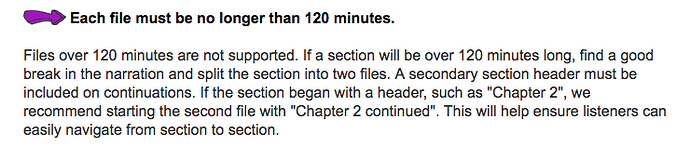

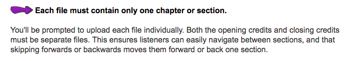

Is this for posting to ACX/Audible? Don’t they require individual chapter files?
I believe Findaway Voices has the same or similar requirements as ACX.
You may run into other technical problems as well. It is strongly recommended that you export your work as ordinary, perfect quality WAV files for archive and storage. WAV files do not support 12-hour productions.
You may have a computer problem as well. How much room do you have? Audacity creates UNDO for some edit events by saving a copy of the whole show.
That means if you work in stereo and have two edits, your two hour show will take up nearly 4GB, and it gets worse from there. Nobody makes only two mistakes in two hours.
It’s strongly recommended that you work in mono (one blue wave) and edit in individual chapters.
