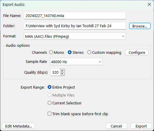

Each time I try to export a file to .m4a Audacity instantly crashes.
This is a screenshot of my export settings.

I cannot reproduce this - Export to M4A(AAC) works fine for me.

I was having the same issue this morning, first time I’ve tried exporting M4A in a while. I also have FFMPEG installed.
I went here:
https://lame.buanzo.org/ffmpeg.php
and downloaded the v5.0 of FFMPEG, installed it and rebooted. Problem solved, at least for me!
Thank you Jim!
I went to that website and downloaded FFMPEG v5 for Audacity 3.x, installed it, and now it is working perfectly.
