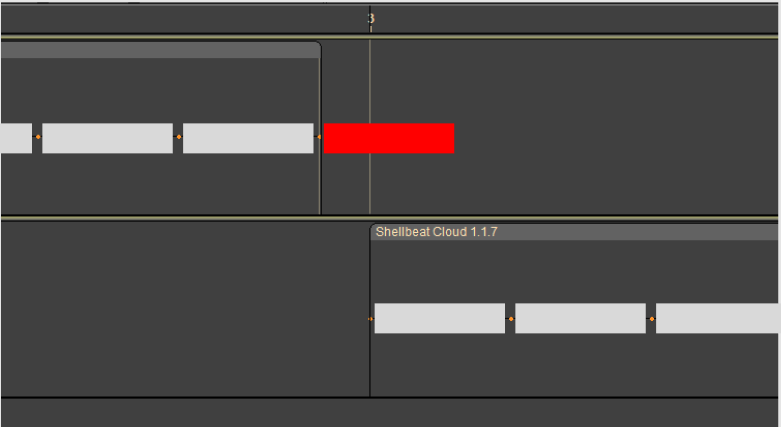

One thing: Enjoying the beat timeline, makes it much easier to time things correctly - except for BPMs that don’t line up with the “dots” (sorry, i don’t know much of the terminology) when fully zoomed in.
This is with 110 BPM.
I understand these are miniscule measurements that wouldn’t harm the final product, but for the production it’s still off-putting having it not line up properly, especially at the 3rd beat… Further down the line this could just become tedious or confusing. I imagine it could also be a pain trying to adjust tracks that are a few “dots” shorter or longer than the beats (or figuring out which one is the fine one if you don’t already know).
I have tried copy-pasting at the point, but doing so joins it onto the first clip, which is usually undesired.
I have also tried using a second track and having it snap properly to the beat, which works…
…but for larger projects with normally 10+ tracks, having to do that for all of them would just take up unnecessary space (20+ tracks for 10 sounds…).
It’s only a small thing, but is it something that can be avoided/worked around or is it just a limitation?
Thanks again.
This is a necessity - these little dots are samples, and are running on a sample rate of usually 44100 samples / second (or 44100 Hz). Your BPM of 110 BPM is equivalent to 1.833 Hz. This can line up sometimes, but absolutely doesn’t have to.
The track is fully quantized all the way through, that is, it has these little dots in regular intervals throughout the track, even if you can’t see them directly. When you paste a clip, it visually gets added exactly at your cursor, but under the hood the samples are all aligned anyway. So in some sense, you just discovered a bug with the sample display :slight_smile:
Additionally - while samples are just points in time, they do live on a grid and thus in practice have some “width” to them. This also isn’t terribly well represented in Audacity, but what it means is that your first clip is just a tad too long:
If you trim that clip a little bit (here: by a sample), and keep snapping enabled, you’ll always be able to drag the following clip as close to the beat line as possible.
