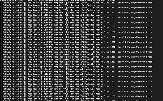

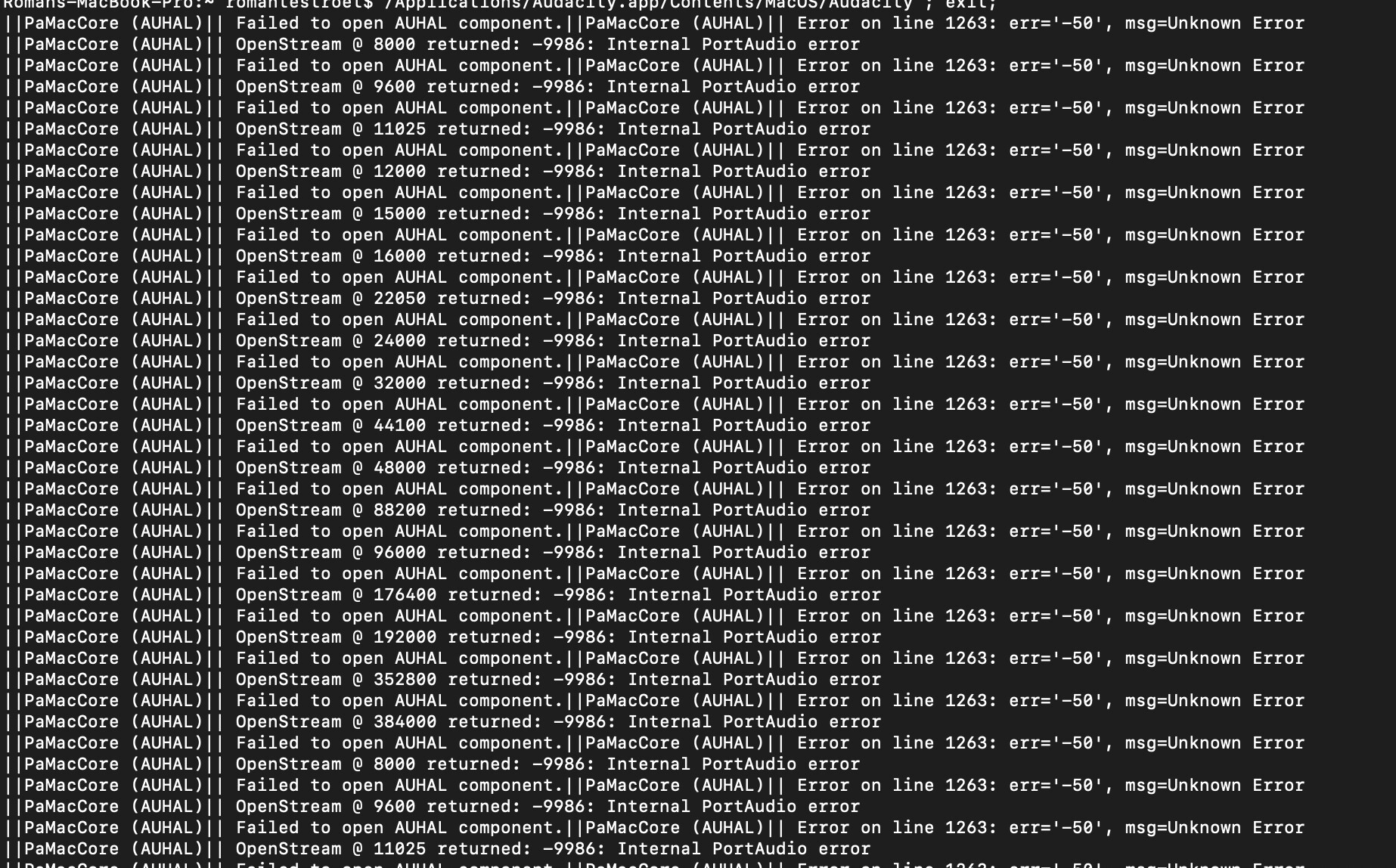

Has anyone figured out how to resolve this issue? I’ve seen a couple folks on this board have it. I was plugging along just fine using the Terminal workaround until this evening, when out of nowhere this began happening to me. When I run the terminal command I now get an enormous long terminal list of errors that read like “PaMacCore (AUHUL)||Failed to open AUHAL component” etc etc etc “OpenStream 44100 returned -9986: Internal PortAudio error” (Not just 44100, but also 48000, 22050, etc etc etc). See attached image.
When I am in Audacity, and regardless whether I opened it with the terminal command or in the standard way, when I attempt to play a sound file I get “Error opening sound device. Try changing the audio host, playback device and the project sample rate” and when I try to record I get “Error opening recording device. Error code: -9997 Invalid sample rate.” See images.
Also of note: 1) All these errors happen whether I’m using an external microphone or just my computer’s mic/speakers. 2) Both Audacity and Terminal are granted audio access in permissions. 3) The sample rate is consistent (44110) in all places, Audacity and across my system, and 4) Garageband and Quicktime audio recording both work just fine. Only Audacity is screwed up, it seems. I have also tried reinstalling Audacity to no avail, and even resetting my NVRAM.
Can anyone help me? I am on Macos Catalina (of course) and Audacity 2.3.3 I’m at my wits end and need this for work. Sincere, humble thanks in advance. :frowning:
