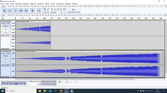

Like in the screenshot? It’s a very strange task.
Catch macros:
SelectAll:
FadeIn:Use_Preset=“”
ExportWav:
P.S. Do not forget that the path for files output by macros must be specified in the settings.
