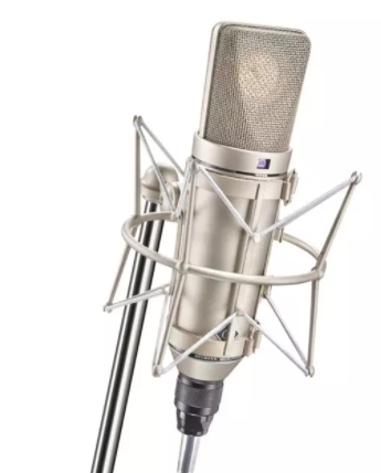

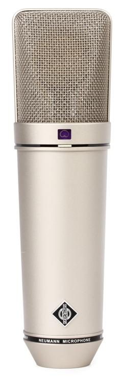

Can’t go wrong with this one… ![]()
Neumann U67.
Hahaha sure ![]()
Even the KM184 is quite a bit out of my league…
My “movie quote” would be “We don’t talk about Neumann mics” ![]()

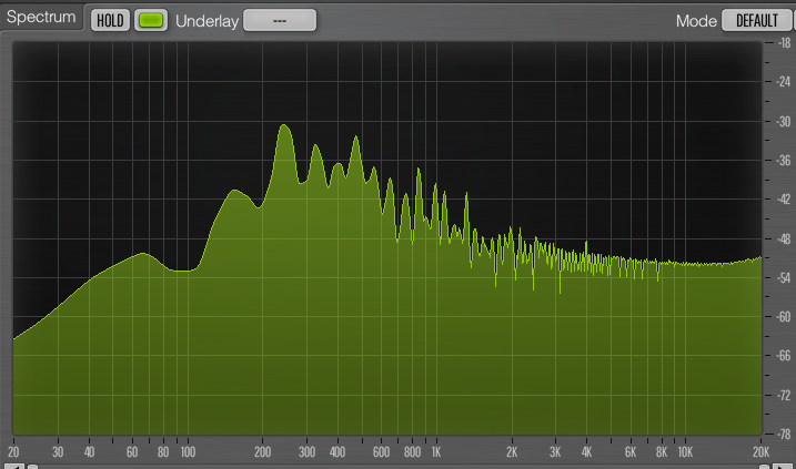

I do have a cautionary tale. I bought an AKG C 414 B large condenser Vocal Microphone. I stopped using it because what they meant by “vocal” was spoken word that was no-nonsense, aggressive, crisp, and hard, not something to sing a ballad into and fall in love with. There is a non-vocal version of this microphone and I believe that’s the respected, popular one.
On a whim, I did frequency runs and sure enough, it has a built-in sibilant “haystack” around 3000-4000Hz. So if you already have a crisp voice, this one is deadly.
Quick specification note. Insanely Popular Microphones aren’t flat and perfect. They’re lightly distorted so they love your voice.

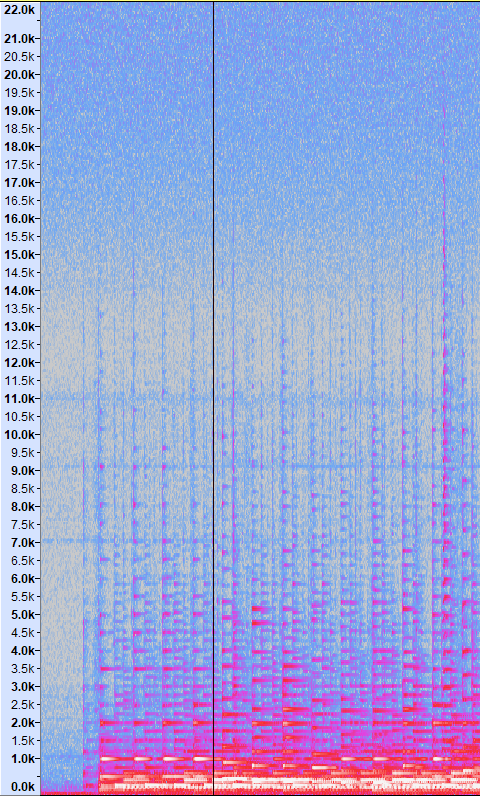

As for your recordings, I think you may have some USB noise in there.
(Quite a few harmonics but the predominant ones seem to be at 7, 9 and 11 KHz.

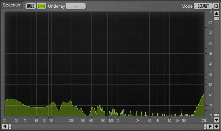

I didn’t hear USB Whine. Can you actually hear it? USB whine tends to follow 1000, 2000, etc.
This damage is super difficult to fix with conventional noise reduction, at least without destroying the performance. We publish a filter specifically for Mosquito Whine (Yeti Curse).
There is a caution that this only works if the whine is USB and that it follows the conventional tonal pattern.
After struggling to fix Mosquito Whine in the field, it was determined that by far the best and most reliable way was change the computer.

As to the USB whine, I couldn’t hear it but there are definitely harmonics present, which seem to start at around 1 KHz, they are weak, but there.
The strongest ones seem to be in the 7-11 KHz range.
I suspect that if Bruno (I assume that is bgravato’s first name) turns up the mic gain to get to around the -12/-10 dB mark,
it will go a long way in masking most of the noise.
Perhaps even getting a USB filter may be just the ticket.
I certainly would not say that the noise is bad, but it may just start to create problems when he starts to apply EQ, gain, compression, etc
to his recordings.

I haven’t done any analysis yet, just a quick recording. Comparing to the AudioBox 96 I tried last year, this Motu M2 has much less noise. The AudioBox 96 had very audible USB noise/hiss which was quite annoying… The Motu is quite a lot better in that matter. I wasn’t expecting it to be perfect for the price tag, but it’s good enough for my expectations.
That sample was recorded with it connected to my NUC mini-pc, which is a bit of a noise nightmare… I’ll try it with a laptop running on batteries next to see if there’s a difference.

With regards to the USB noise, it certainly ain’t bad and like you say, most of it could be caused by the NUC.
