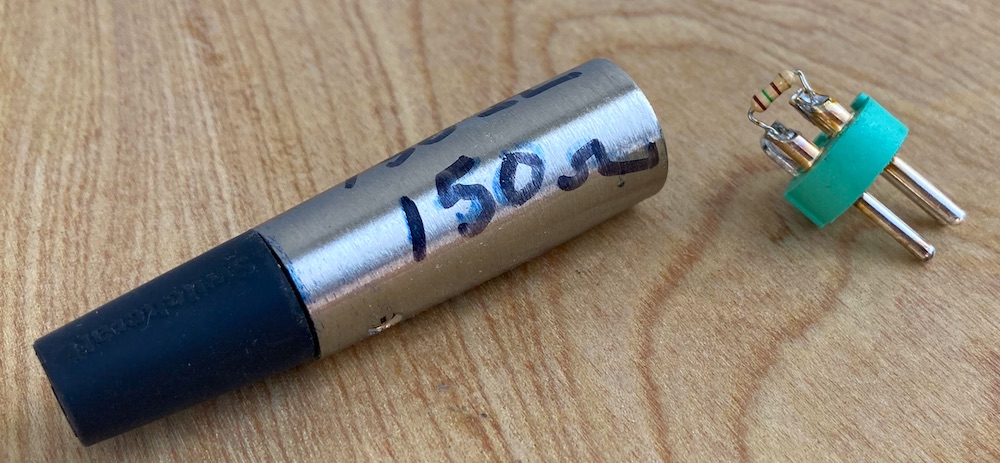

Found it.
This is a “fake” 150 Ohm microphone for noise measurements. Brown, Green, Brown, Gold. One Five One at 5% accuracy and it’s a well behaved metal film resistor. It’s mounted between pins 2 and 3 which is where the actual sound element connects.
There was a Public Address sound standard that wasn’t wired like this, but that hasn’t been common in years.
