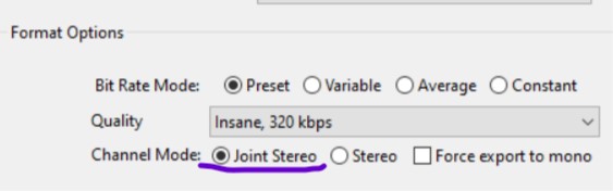

By the way, is “joint stereo” still present in Audacity version 3.4.0 and later? It seems to me that not. Where did it disappear? You’ve redone “Export” so that I can hardly recognize it! Too many changes at once, it’s hard to re-learn, better gradually. (((((
Joint Stereo is actually still present in Audacity 3.4.x - in fact it is now the only option (and hence no radio button choice). Although it says “Stereo” in the export dialog, it’s actually “Joint Stereo”.
Muse decided to remove the pure Stereo option for 3.4.0 and onwards.
AFAIK I think this only applies to MP3 exports.
