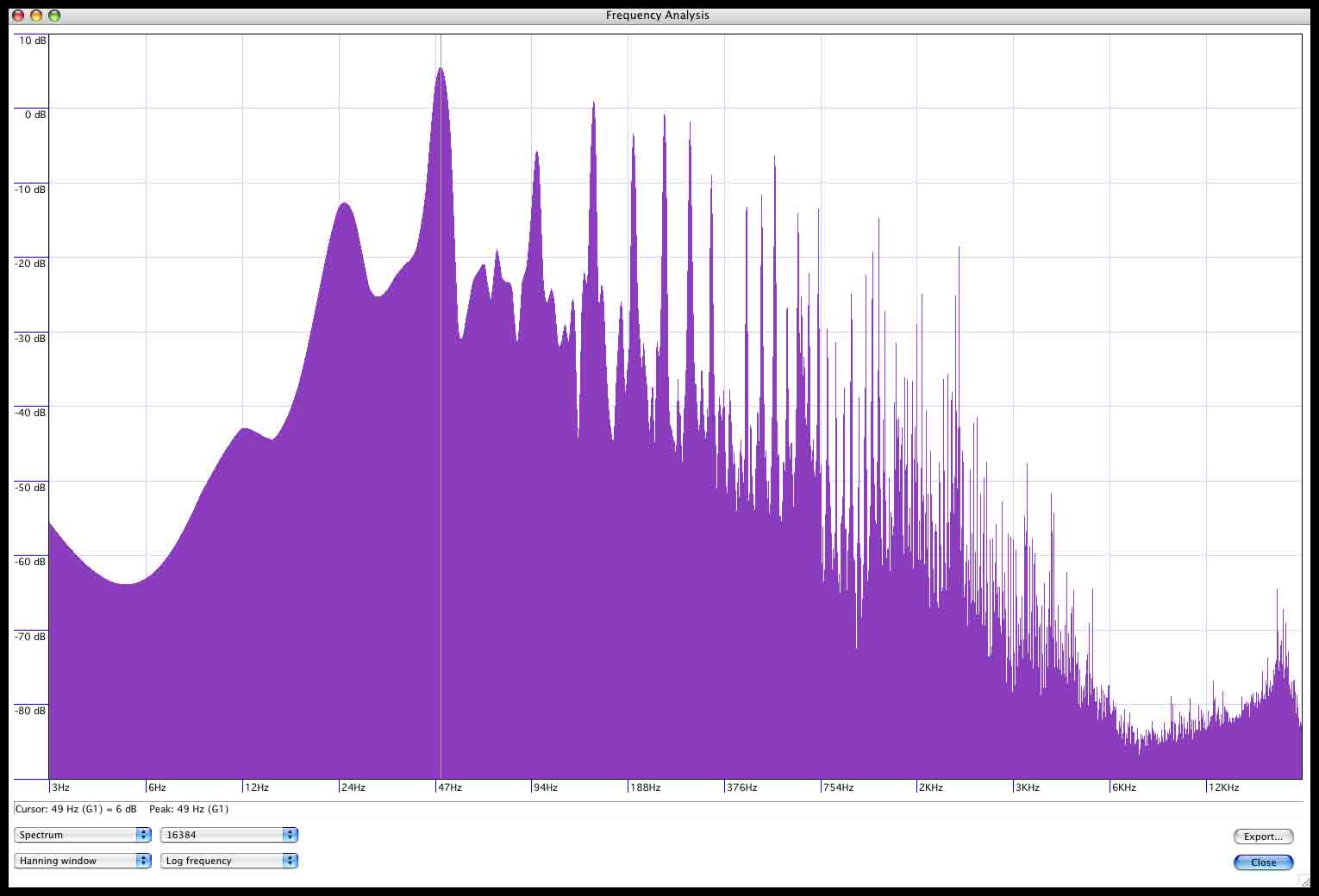

The arithmetic works out really well in linear frequency, but you hear in log. 400Hz sounds like it’s about in the middle (440 Hz is the oboe “A” at the beginning of a concert), but it’s clearly not half-way between 20 Hz and 20,000 Hz. The “size” of the sample increases the accuracy as you go up, but sometimes actually tells you less because of the need to analyze all the data
This is an analysis of one single piano note. Note the “size” of the sample is really high, so that’s the graph of every pitch, harmonic, and overtone in the note. The fundamental almost gets lost in the forest of junk.
http://kozco.com/tech/audacity/piano_G1.jpg
