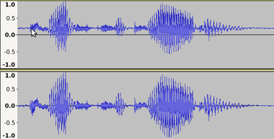

In this image you can see that the upper track is not centred vertically. It is “off-set”. We can correct this fault by using the Normalization effect with “Remove any DC offset” selected. Using Normalization set with this selected, but with “Normalize maximum amplitude to” not selected, will correct this off-set without making any other changes to the amplitude - the result will look like the lower track.

In fig.2 we have applied the Amplify effect to a waveform that had DC offset (upper track), and in the lower track we can see the same waveform after the Normalize effect has been used with DC offset correction.
In both cases the maximum peak amplitude was set to 0.0dB, but note that in the upper (Amplified) track, the resulting waveform is noticeably smaller than in the lower (Normalized) track. Also, you may notice that the DC offset has become worse when the Amplify effect has been used - the DC offset has also been amplified.
The reason that the Amplified waveform is smaller is that the positive peaks have been shifted up vertically by the DC offset, so although the positive peak is at 0.0dB, the negative peak is far away from the -1.0 level.

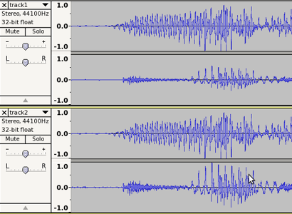

Let us see this effect on a stereo track. In fig 3 we can see two stereo tracks - they each have 2 audio channels - a left channel and a right channel. Note that the peak amplitude of the Left (upper) channel of each stereo pair is quite a bit greater than the peak amplitude of the Right (lower) channel.
We will now Amplify track 1 (the upper track) to 0.0dB and we will Normalize track 2 to 0.0dB
Note that the in the upper stereo track, both Left and Right channels have been Amplified by the same amount (about 1.0dB).
Note that in the lower track, each channel has been processed independently so that each channel has a peak value of 0.0dB - they have each been Normalized to 0.0 dB
