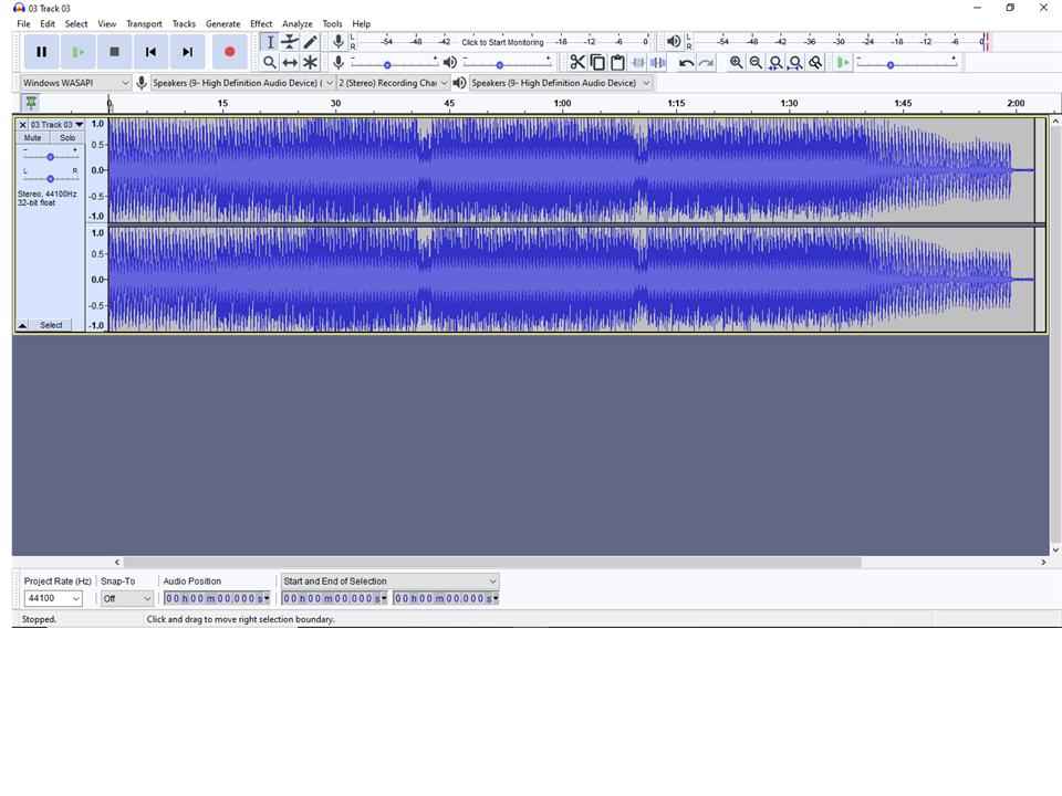

Hi Steve,
Thank you for your reply I have screen captured the version, please see attached!
Thanking you in anticipation ! Cheers
At the bottom of the Ambeo Orbit window, is there an “Apply” button?
