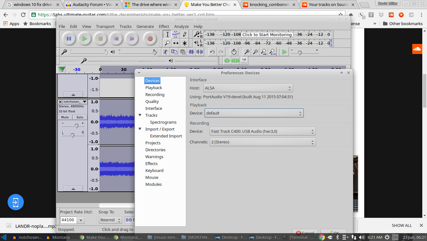

up to my neck with Audacity problems for some reason lately. Have current issue in discussion on Mac section. Trying to use my Ubuntu Studio version. For past couple months have noticed the app is freezing up all the time. Doesnt seem to be any indication as to cause. Am attaching screenshot of the message that comes up. Message only comes up trying to close the window from taskbar. In the app itself clicking on anything once it’s frozen does nothing. Always have to close the window from the error message and hope Audacity recovers the project next time it’s launched. Any help? Ubuntu STudio 16.04

From your screenshot, I notice you have a very recent alpha build of Audacity and have no choice boxes in Device Toolbar. That “probably” means Audacity can’t find any audio devices, in which case the freeze is obviously explained. See http://wiki.audacityteam.org/wiki/Mixer_Toolbar_Issues#No_devices_available.

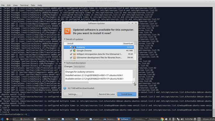

above was affecting mostly my debian based distro but this one is Ubuntu studio and has similar problems. I have also noted that the past week or 2 weeks I had gotten an update for audacity on a daily basis. either running apt-get update/upgrade or initiated by Ubuntu software updates app. I keep seeing what appears to be the same build offered as upgrade or update when this happens.

So this here that wants to throw me an “update” is from Ubuntu and not you guys?
I had added it months ago but just in the last couple of weeks has it been giving me these daily “updates”.
Funny they never mention that it is not from Audacity and seems they try to make it look like it comes straight from you guys. A bit sneaky.
Anyone know what is the difference or what these are doing/updating?
there was a disclaimer at the bottom of the software update windows i’m posting here in this message that conveniently states “This update comes from a source that does not support changelogs”. How nice of them! Who has time to read all that mumbo jumbo anyway :sunglasses:
If you look close they are calling this 2.1.2+
