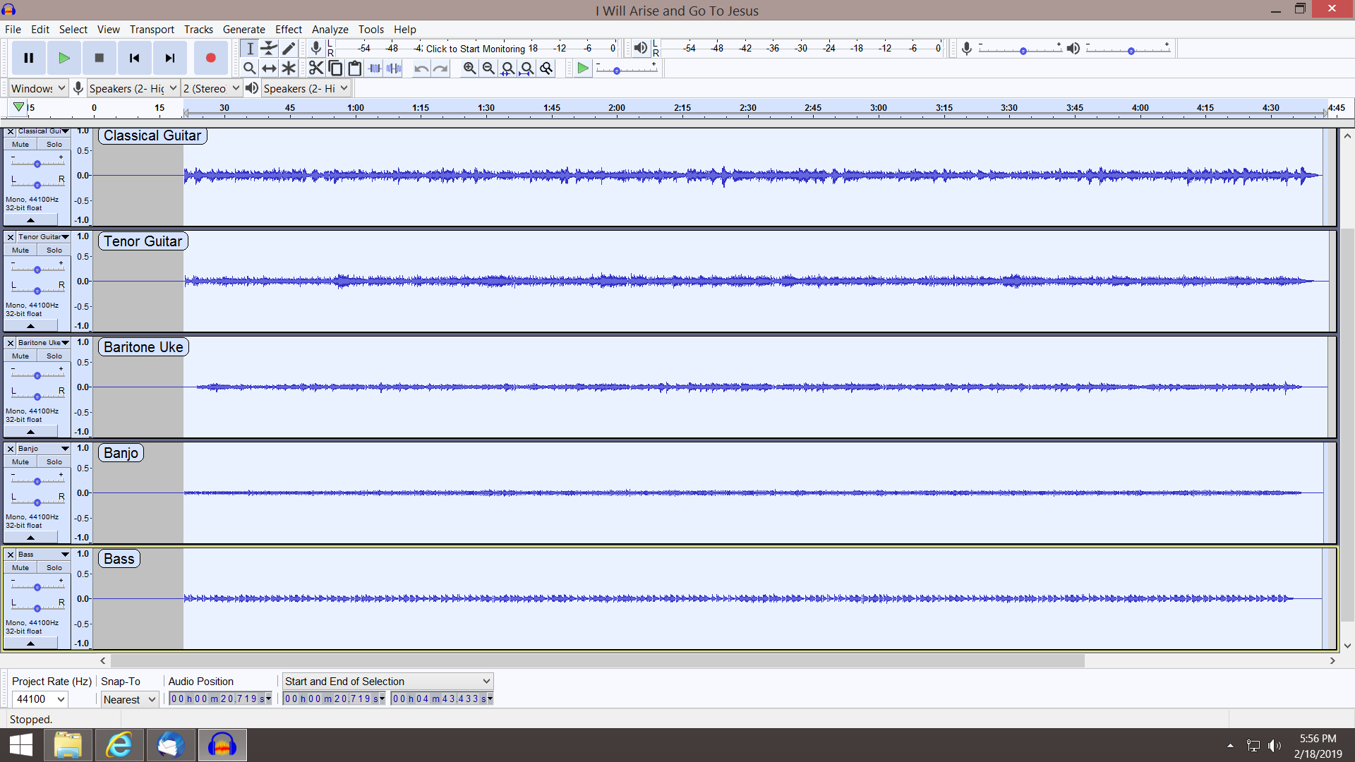

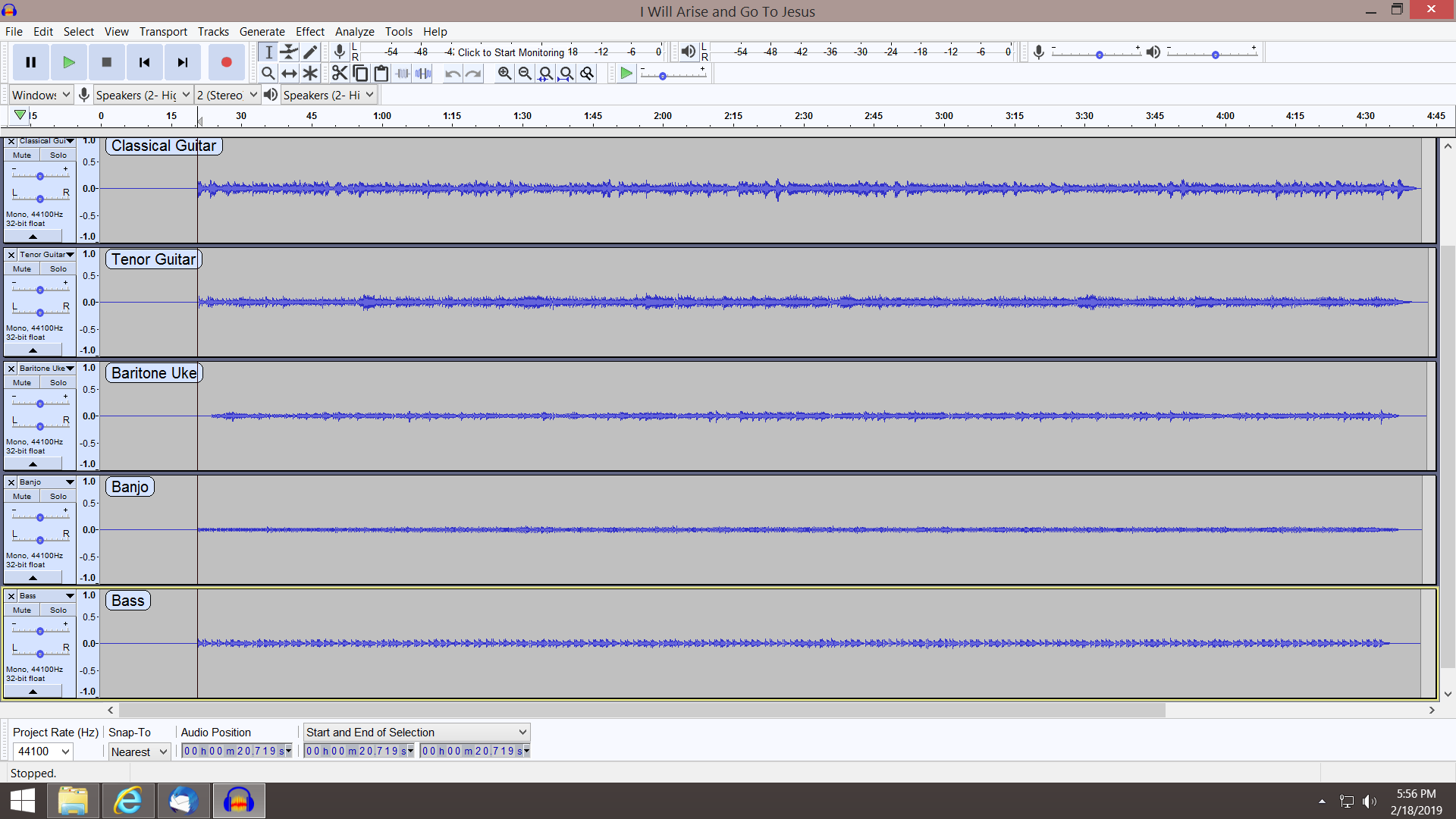

Here are a couple of Screenshots for you steve. I haven’t done any editing to them at all so maybe you can see them good enough. I’ve placed the cursor at the beginning of the audio. All of the tracks but the baritone uke look like they are in alignment but they aren’t. Each one is slightly off.

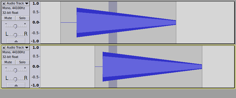

When aligning tracks together, it is the start of the track audio that is aligned. Flat-line “silence” is valid audio, just as much as wiggly line audible sound.
Example before alignment:
Example after alignment:
If you wish the align the “start of the audible sound”, then you can either align them manually (with the Time Shift tool), or you could trim off the leading silence first.
If the leading silence is “absolute silence” (-infinity dB), then you can trim the silence automatically with the “Truncate Silence” effect (https://manual.audacityteam.org/man/truncate_silence.html).
If the leading silence is not “absolute” silence, but just “very very quiet”, then you could either, silence it manually (https://manual.audacityteam.org/man/edit_menu_remove_special.html#silence_audio), or silence it with a Noise Gate effect (for example: https://wiki.audacityteam.org/wiki/Nyquist_Effect_Plug-ins#Noise_Gate).
Alternatively, if the leading silence is not “absolute” but just “very very quiet”, you could automate trimming the silence with this plug-in: https://wiki.audacityteam.org/wiki/Nyquist_Effect_Plug-ins#Trim_Silence
This is probably the best approach for your specific job.

In short, and for the benefit of other readers that may not have understood what I was trying to say:
In this project, all of the tracks are aligned to time=0.0
It is the start of the “track” that is aligned by the “Tracks > Align Together” command, not the start of the music in the track.
