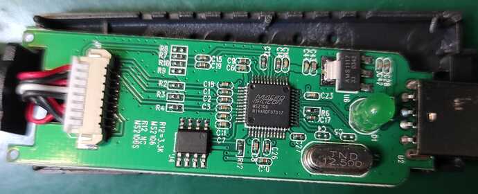

I recently bought a USB Audio Capturer to convert my analog audio to digital. The unit acts as USB mic to Windows but, unfortunately and disappointedly, Widows sees it as a mono mic.
After fighting against driver, even digging in capturer IC, I believe there is nothing to do this way.

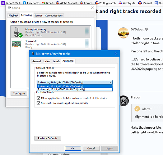

This, I believe, is a Windows issue.
You just need to go into the Windows settings for your mic input device and set it to be stereo.

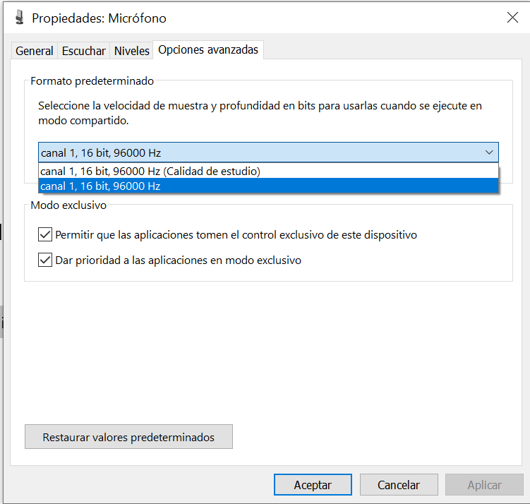

I already tried it but when going to device configuration Windows only offers me these 2 options:
  1. Channel 1, 16 bit, 96000 Hz
  2. Channel 1, 16 bit, 96000 Hz (studio quality)
I suppose it means that driver, or hardware, or both are mono devices.
I already unsuccessfully tied with supplied and other web drivers, Windows always say that installed driver is best driver, maybe because all drivers I tried are unsuitable for this device because if I try to force them manually, Windows always says that they are not for Windows… when they are.
I have also opened the Capturer Unit and see it is based on IC MS2106, but I am unable to find its datasheet to dig more this way.

This is what I see on my HP Envy laptop

I can’t believe my Cpaturer is mono either, but this is what I get in Windows, whatever driver I use:
I would prefer to solve this “mono” problem instead aligning both separate stereo tracks, but I don’t know what else to do. I am in the believe that this cheap unit bought at Aliexpress is a bull shit, even that, I am sure it has stereo output and the problem is matter of drivers ( I would confirm that if finding datasheet MS2106).
