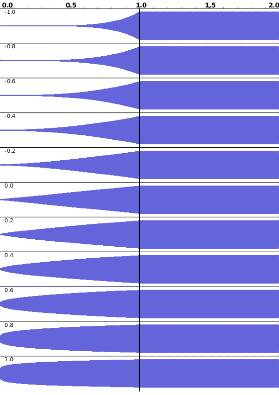

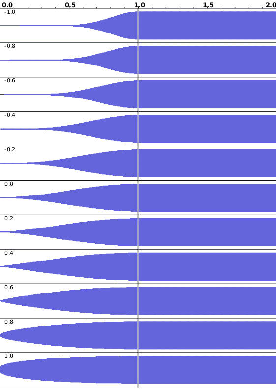

I’ve modified the “Mid-fade” slider to a new non-linear scale. It still has the same range of fade curves as version 23, but the scale is now shown as +/- 1.
These are the “Fade In” curves that it produces (slider values in steps of 0.2 from -1.0 to +1.0)

The main feature requested on the wiki is:
Fade In/Fade Out:
  • New controls for start and end amplitude - quick linear fade from say 0.8 to 0.2, much simpler and quicker than the Envelope Tool (and VI-accessible)
so I think this feature should be central to the plug-in, as in version 23.
Generally I like presets in plug-ins, but they can become problematic in Nyquist plug-ins as the interface does not support either the controls reacting to the preset, or greying out of disabled controls.
The purpose of presets in any program is to provide convenient access to commonly used settings.
I think that we can go back to a layout similar to version 23 (which looks like the favourite so far) if we add logarithmic and exponential fades.
Using the “Soundtrack Pro” terminology, the logarithmic fade could be configured to provide an “Equal Power” curve when Mid-Fade level is zero.
This then provides the following “preset” shapes when Mid-fade is at the default (zero):
  • Linear
  • “S” curve
  • Logarithmic (Eq Power)
  • Exponential
Fade in and fade out versions of each preset could be selected by choosing “Fade In” or “Fade Out”.
I think this would provide a sufficient number of presets without having a separate “non-adjustable preset” selection.
