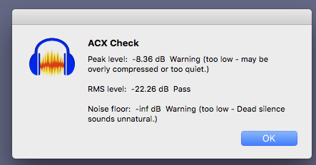

I am, like others, evidently, having trouble with the Noise Floor fail on Audacity’s ACX check.
It keeps failing the check. As an experiment I bumped the white (or pink, or gray…tried them all) noise up to a ridiculous -10dB and it still told me the noise level was “too low”.

Just so we don’t get lost. Your ACX-Check third reading—Noise—looks like this, right?
Pauses in your presentation should default to gentle background sound (ffff) or “Room Tone.” Yours is being keyed out to total dead zero because something in your recording pathway is “helping you.”

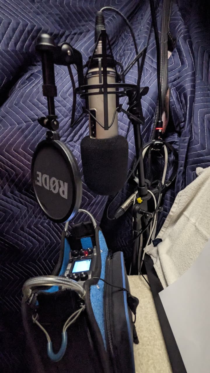

I do not record directly onto my Mac. My record chain is a Røde NT2-A mic directly into my Zoom F6.

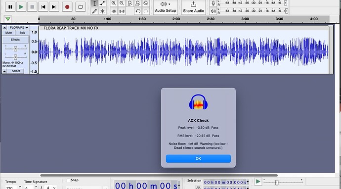

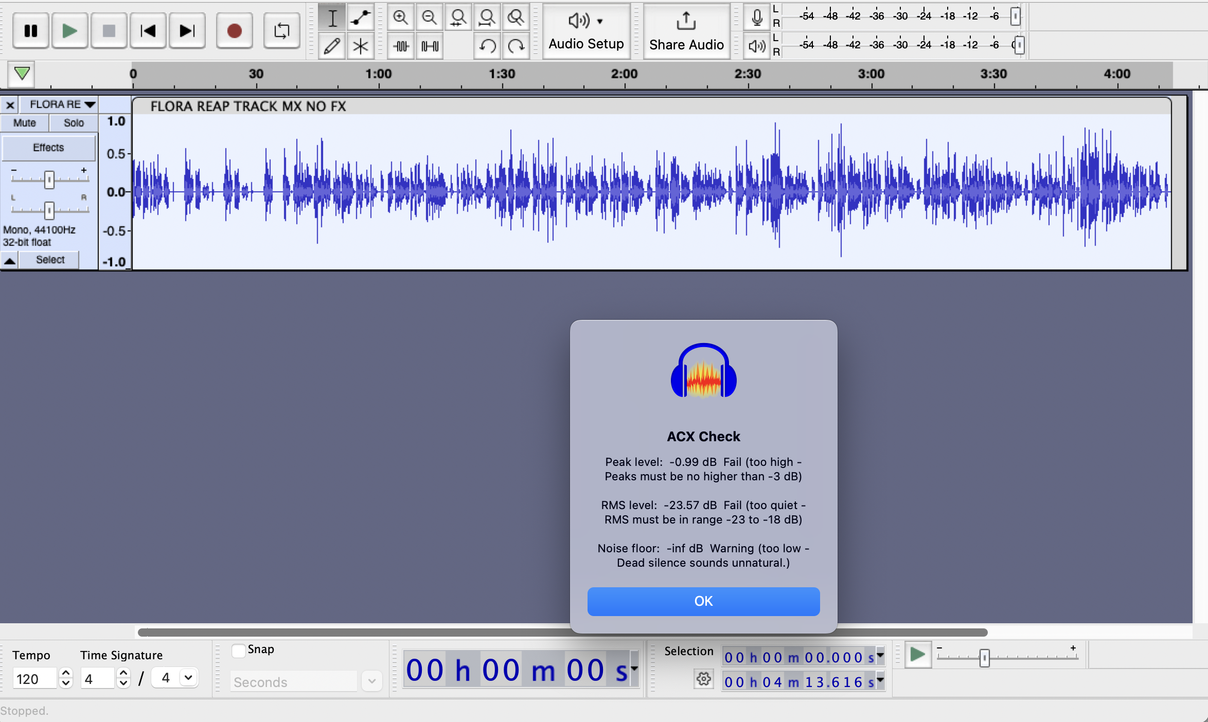

That file was imported into AUDACITY. As a test I ran the ACX check on the imported file (picture 4). That resulted in Pic 4, an ACX fail on 3 criteria.
I then used the “Audiobook-Mastering-Macro” and ran the ACX again.
That resulted in Pic 5, Peak and RMS ok but the noise floor still too low.

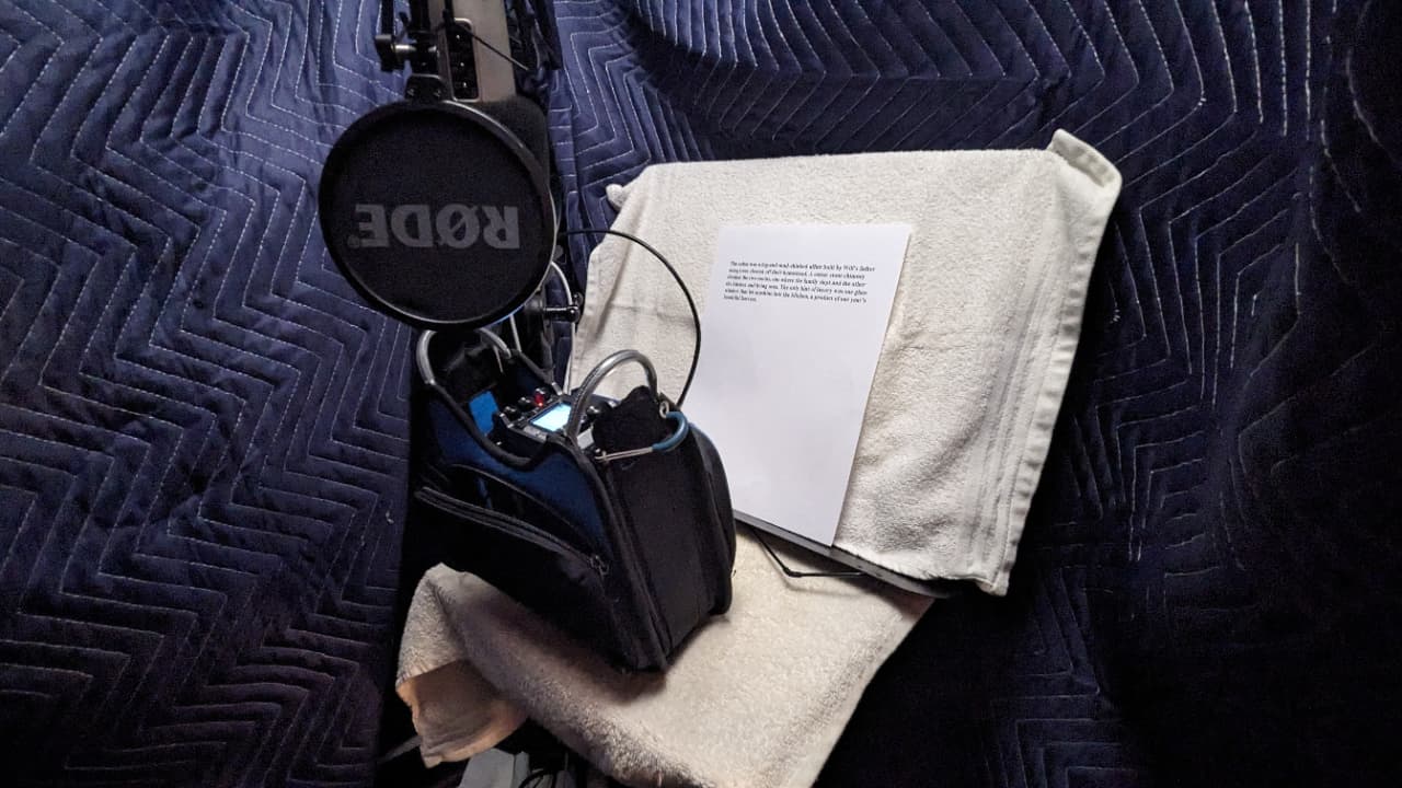

The attached picture is
- My booth set up
The F6 is a very high quality field recorder. This is me digging in the manual.
That thing in my illustration is a Zoom H1n.
