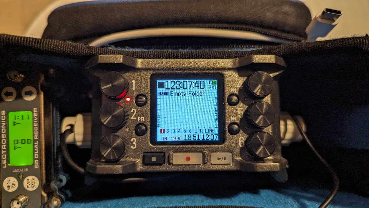

I have the F6. It’s a professional six channel, 10 track recorder, with timecode. That’s my back-up recorder. That’s why it’s parked in my VO booth.
There is no noise reduction on the F6 other than high pass filters. It has an automix option but since I’m only recording one track I don’t need that.

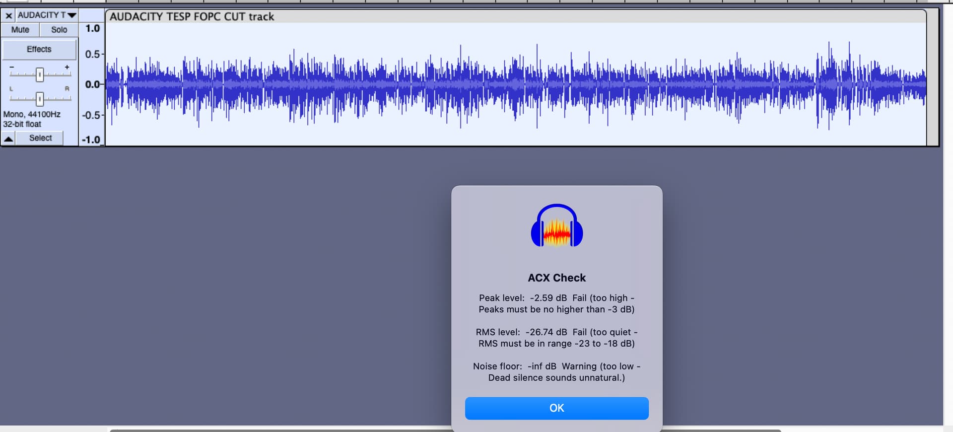

Based on the note by DVDdoug, I think I would select a copy of one show, add noise, and render to a single track. With nothing else on the screen, drag-select a large portion out of the middle of the new track and run ACX-Check again.
Okay. I’m thinking there’s something wrong with Audacity somewhere.
I just took our Sunday sermon (WAV), cut heads and tails off and RENDERED it out as WAV. No processing at all, not even gain changes.
Again, this was from our church service yesterday. Mic on the pulpit. There’s definitely some street noise in the track.

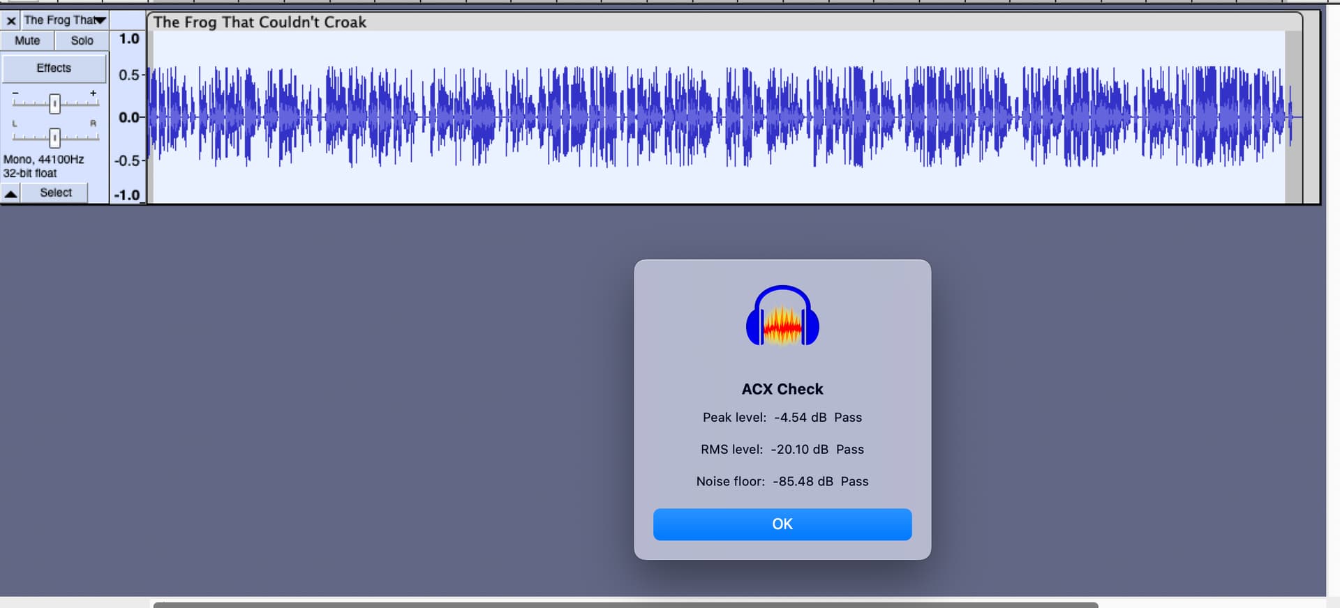

Ran the ACX check in AUDACITY with the track input as a WAV track and got the following (No mastering macro was run, this is what the track simply opened in Audacity shows).

I went back to my original finished track, did the select as you suggested and got a pass.
Wierd that excluding the heads and tails makes it fail…but oh well.
At least I know everything is good.
It’s not seeing that as “silence” or “noise” and there is probably silence somewhere else in the file.
-@DVDdoug
And the test noise track I added ran the entire length of the narration…so??
-tsmyles

Selecting the beginning of the track through almost to the end is fine.
Selecting to include the end, which has a bit of tails silence causes it to fail.
So guess I just have to cut tight to head and tail…
ACX-Check doesn’t care where the silence is. Any silence in the presented data counts. Can you tell why the tail is there? That’s not normal.

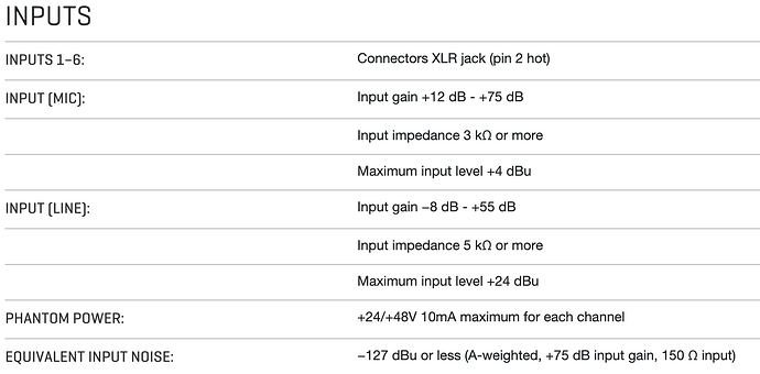

FYI attached are the input specs for the Zoom F6 and an article on it. It’s quiet. Oh that my old analogue tape recorders were that quiet.
My gain trim on the mic is +45dB…on the high side for me but just over 1/2 of the available gain. (My other recorders don’t need that much gain with this mic. And they are transformer inputs).
The F6 does have a 32 bit float mode (as well as simultaneous 32/24) but I hardly ever use that, only 24 bit. Certainly NOT in this application. My booth (closet) is small and this is what I’ve wound up with.
