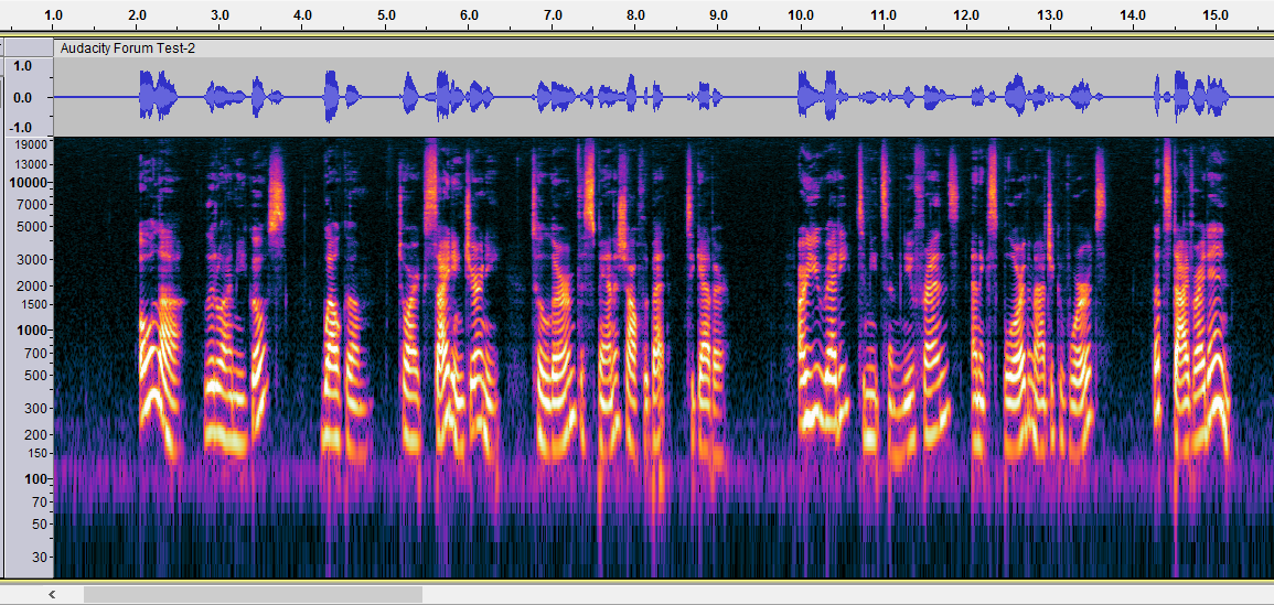

Sometimes we can tell from the blue waves on the timeline what’s wrong. Your sample will not let us download the file, and besides, it’s after processing.
As a fuzzy rule, the Yeti microphones do very well. They’re really popular—and no, they don’t have any “settings” other than the knobs. You do have an odd knob, though. Home microphones tend to be quiet. I would have guessed a “Gain” setting of much higher. Your test will show that. Remember, do not apply any corrections after you read it. Just export the WAV file and post it no matter what it looks like.
The dark horizontal bands on the spectrogram are the “telephone booth”/“wine glass” effect.
