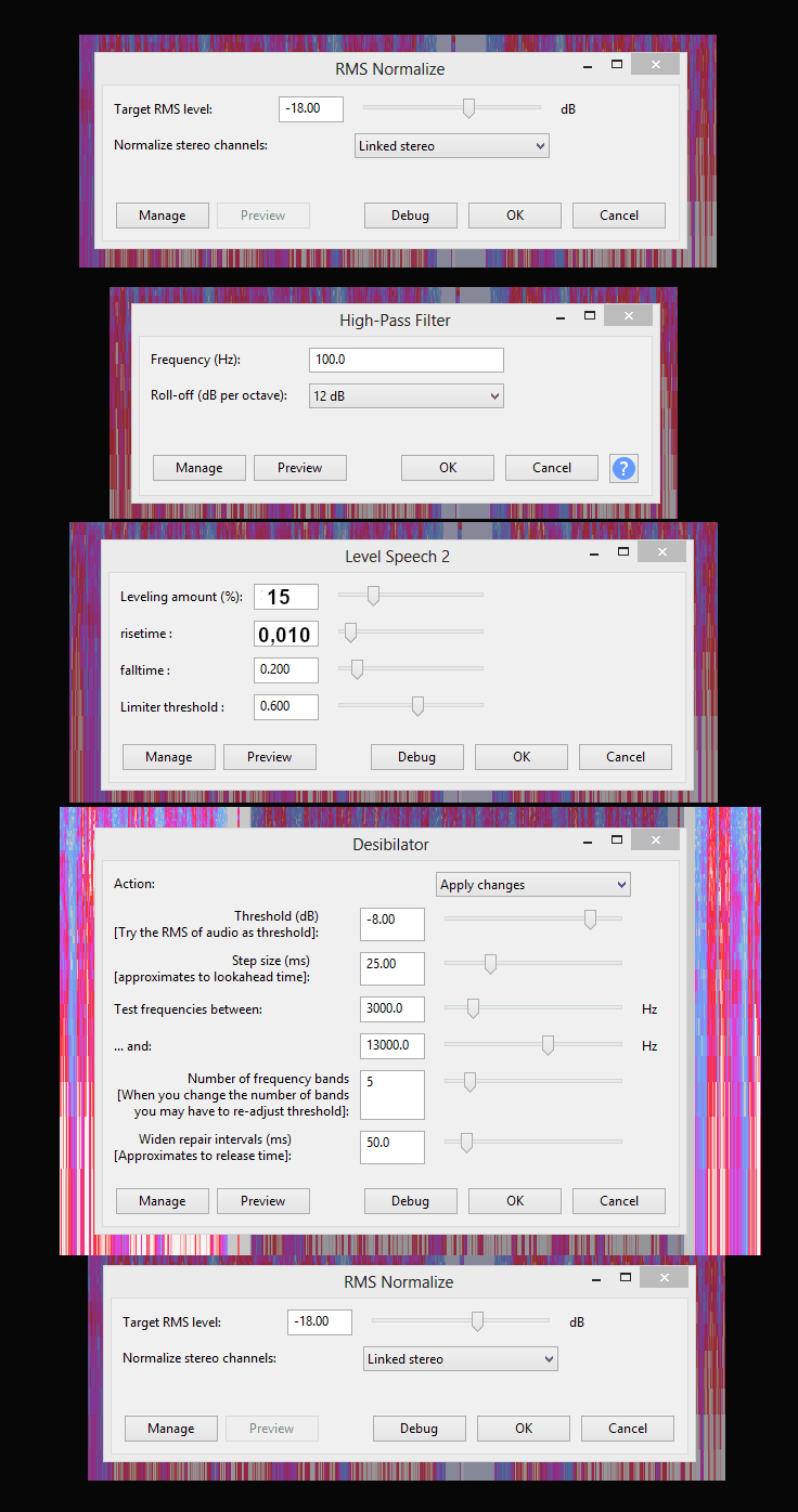

Using a (single band) limiter or compressor with make-up gain will inevitably increase sibilance.
So, IMO, De-Essing should be applied after any limiter/compressor/EQ.
Desibilator, LevelSpeech2, RMS Normalization = Loudness Normalization
Could make a macro of this list of effects to apply them in one fell swoop.
Holy smokes – that is INCREDIBLY helpful. Thank you very much for taking the time. I really appreciate that!
