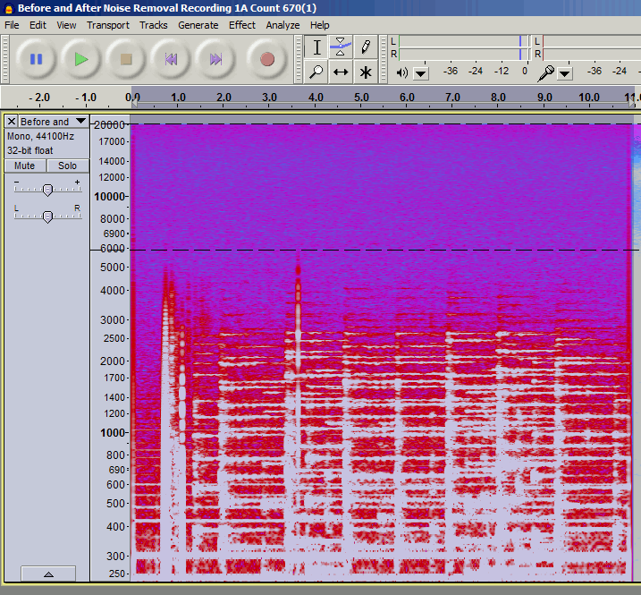

Spectrogram View shows no piano music above 6KHz , so frequencies above 6kHz can be removed it is just hiss noise.gif

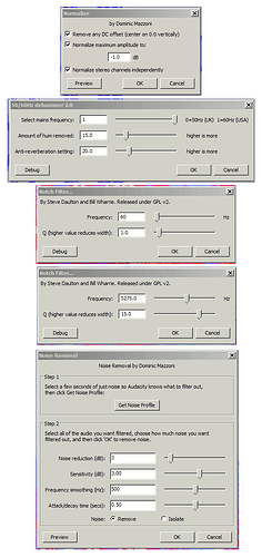

The hiss on that recording is already quite low, I’d be tempted not to use any noise reduction, however a small (3dB) amount of noise reduction seems to be the threshold , beyond that IMO it does more harm than good in this example, see my suggestions below , (click on the image to see it in it’s entirety) …
Filter sequence suggestion for ''Original Master No Edits of Family Recording 1A Count 670(1)''.png

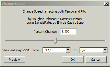

The tape is running slow on that recording : I can tell than because the 60Hz mains hum fundamental frequency is about 58.6Hz on the recording. So the standard de-hum plugins which only offer 50/60Hz options aren’t going to work properly on recording with a 58.6Hz + its harmonics.
You can adjust the speed of the track so the 58.6Hz becomes 60Hz , then apply the 60Hz dehummer.

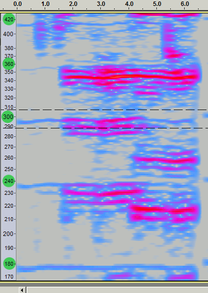

If the tape speed is not constant throughout the recording the standard dehum filters aren’t going to work as well because the hum harmonic frequencies the dehum removes are not where they should be …
Spectrogram shows 60Hz mains hum harmonics are lower than they shound be and a bit wobbly because of tape speed variations.gif
