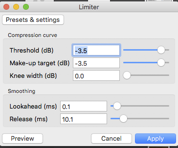

Effect > Volume and Compression > Limiter. That’s the new one. It has two settings and I just doubled them up.

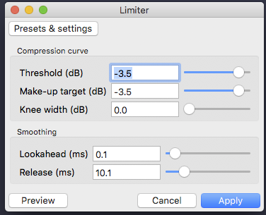

It’s not rocket surgery. The new Effect > Volume and Compression > Limiter has two places to set the limit.
