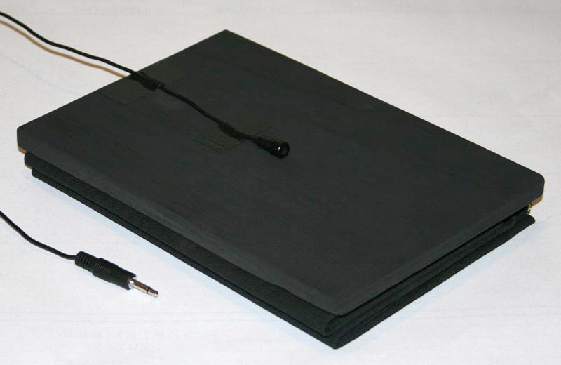

This is a lavalier or chest microphone jiggered into Pressure Zone form.
Here it is finished with a coat of paint. DO NOT paint the microphone. That’s flat black, high temperature grill paint. Stable and wears like rocks.
That’s layers of heavy black felt (Duvetyne) underneath for sound isolation.
