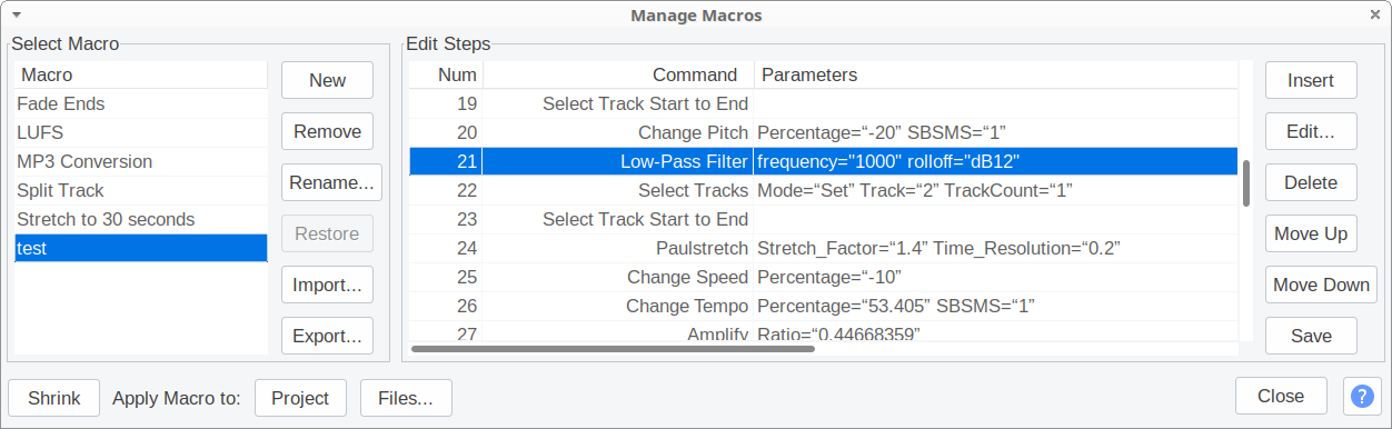

Your batch command for lowpassfilter was not recognized
I’ve been trying to get a macro running that simulates the sound of the Mechanicus teaser trailer.
Whenever I try it, it will give the error message in the title.
Here’s the macro in full:

LowPassFilter:frequency=“4000” rolloff=“dB12”

I am rather new to this so any help is appreciated.
It should be Low-Pass Filter not LowPassFilter.
Actually, it’s Low-PassFilter, but thanks for putting me on the right track!
That depends where you look :slight_smile:
