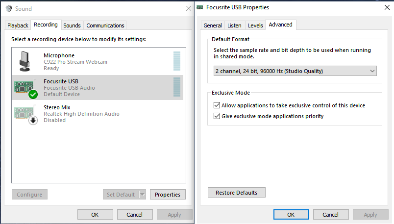

I’m using the Focusrite Scarlett 2i4 audio interface along with a Shure SM7B for recording.
The problem I’m having is that the Scarlett 2i4 has two channels, and I sometimes record things with someone else using two mics, so I have my Windows audio settings to “2 channel.” However, when I go into Audacity and record in Stereo, there’s only audio on one channel. When I have both mics turned on, there’s audio on both channels, one mic per channel (one on left, one on right).
Is there a way in Audacity (or Windows even) to have both mics distributed evenly across both channels? I hope this is making sense. I attached a screenshot of the audio settings and what the track looks like when I record within Audacity.

As you can see, I do have two XLR mics regularly plugged in, which is why I also have this as my default Windows settings:

The setting in Windows should be “2 channels”. This allows the computer to correctly access both channel 1 and channel 2 of the Scarlett 2i4 .

Leave the settings in the Windows Sound Control Panel for recording “2 channels (stereo)”, and in the device toolbar, select “1 channel (mono)” when using only channel 1 of the device, or “2 channels (stereo)” when using both channels of the device.
