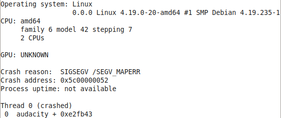

No idea, Audacity immediately crashed.
AudCrash
Running the AppImage if that makes any difference.

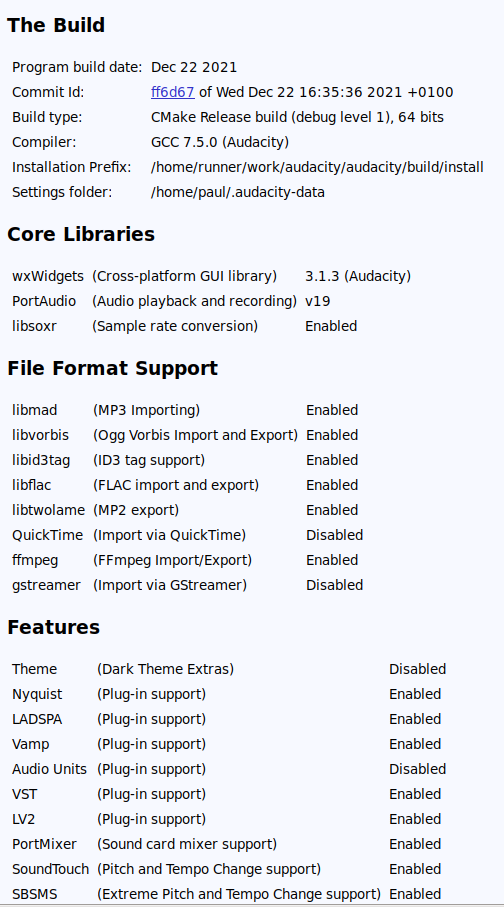

Which AppImage version? (There have been a couple of recent versions that crash).
Details below:

The version number will be something like:
Audacity 3.1.3
You will find the version number in “Help menu > About Audacity”.

@Steve
AboutAudacity-2
AboutAudacity-3
