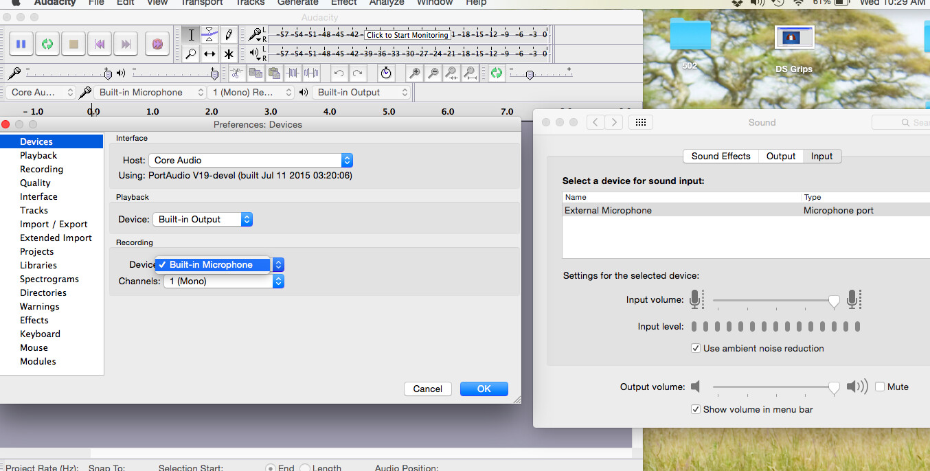

I have a MacBook Air running OS X 10.10.5. I also have a iPhone 6. I want to use Audacity to record voicemails off my iPhone into a file on my MBA. I’ve bought a four conductor 3.5mm cord. My MBA recognizes my iPhone as an external mic when using the the 3.5mm jack. But, Audacity does not.
You’ll see in this screen shot that on the right, the MBA recognizes the iPhone as external mic. On the left, the input menu does not see the external mic. Any ideas?

I should mention that I’ve tried rebooting it with the jacks plugged in (and out and every combination), and I’ve even done the ‘Transport > Rescan Audio Devices’, and still nothing.
Why does Sound Preferences not see the “Built-in Microphone” that Audacity does? Does the internal mic get disabled when you connect that cable?
Have you tried recording from that “Built-in Microphone” source, in case there is a naming confusion?
If that does not help, try going into /Applications/Utilities/Audio MIDI Setup and fiddle with the settings. Try a mono format and 44100 Hz, in particular, if there is a choice. Quit Audio MIDI Setup then restart Audacity.
I don’t know why it doesn’t see it. I wish it did. I believe the internal mic does get disabled, as I can watch the audio peak on the ‘Sound’ level meter in the control panel (not in Audacity).
