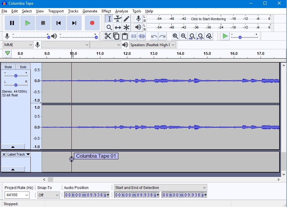

When you open the project, can you still see the labels in the label track?
Yep. Here’s a screenshot.

In your project, the first label track is track 3, and it has no labels in it.
Thanks! I don’t know how those empty tracks got there, but I hadn’t noticed them. I feel pretty stupid. Thank you so much for the help!!!
