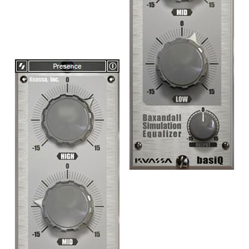

Kuassa Basiq. Some might not see this as an eq, as it only has three knobs. It’s tone is wonderful, however.
