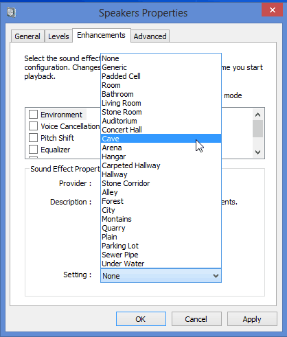

The reverb effect is a playback “audio enhancement”,
such enhancements should be disabled (unchecked) for faithful playback …
NB: there can be two layers of “audio enhancements”:
Windows and a second one, sometimes called MaxxAudio.
You need to turn off both.
I FOUND THE ANSWER!!! Windows 11 automatically puts an effect on the OUTPUT so no matter what I did it still had reverb on it. This is what I did to shut that off
SYSTEM>SOUNDS>SPEAKER/HEADPHONES (REALTEK AUDIO)>AUDIO ENHANCEMENTS
switch to OFF.
