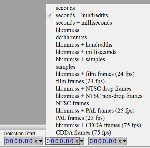

Here is the current situation:
You will see that I have added a couple of additional “seconds + …” entries and reordered the list so that they fall in the “appropriate” place. The actual number of decimal places displayed is simply a matter of adding zeros to the format string to match the number of decimal places you desire.

Now that the index isn’t hardocded I tried adding ss + microseconds and hh:mm:ss + microseconds but it certainly does not work as well as it did in 1.2.6.
In an empty 44100 Hz project window we see that TimeText controls start at 1 microsecond instead of 0 (as per your image above), and start at 3 microseconds at 1000000 Hz.

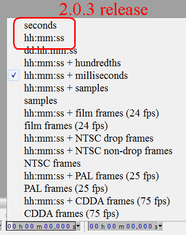

HEAD doesn’t include microseconds. Yes I tested Suizokukan’s patch to add seconds and milliseconds (which is fine) and also added seconds and microseconds and hours, minutes, seconds and microseconds (attached).
