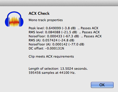

I get -55.1dB, but yes, the evil, rumble, vibration sounds are gone. That must have been building noises from the floor.
There you lose me. I mastered with the three tools and ACX Check gives me noise of -55.3dB. Mastering usually boosts voice volume, but the first tool, Filter Curve takes out some rumble sounds, so in your case, it came out almost even.
I applied Noise Reduction of the beast (6, 6, 6) and got -61.3dB not -65.7dB, and no, that’s not enough.
It does meet ACX specifications and you could submit that way, but if you do anything wrong anywhere, the reading is going to fall out of compliance.
You could opt for a much stiffer Noise Reduction. 12, 6, 6 will give you an easy pass.

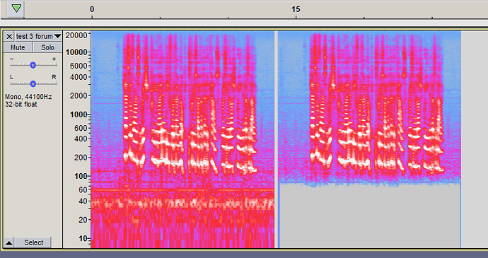

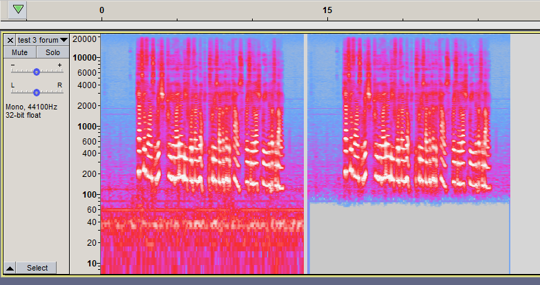

There is another forum poster who failed one of the chapters in the middle of her book. We’re working out the best way to rescue it without damaging her voice.

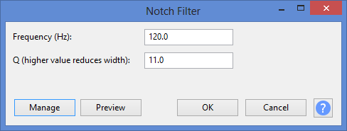

Filtering out everything below 70Hz, then applying a Notch at 120Hz,
reduces the noise-floor measurement by over 16dB …
