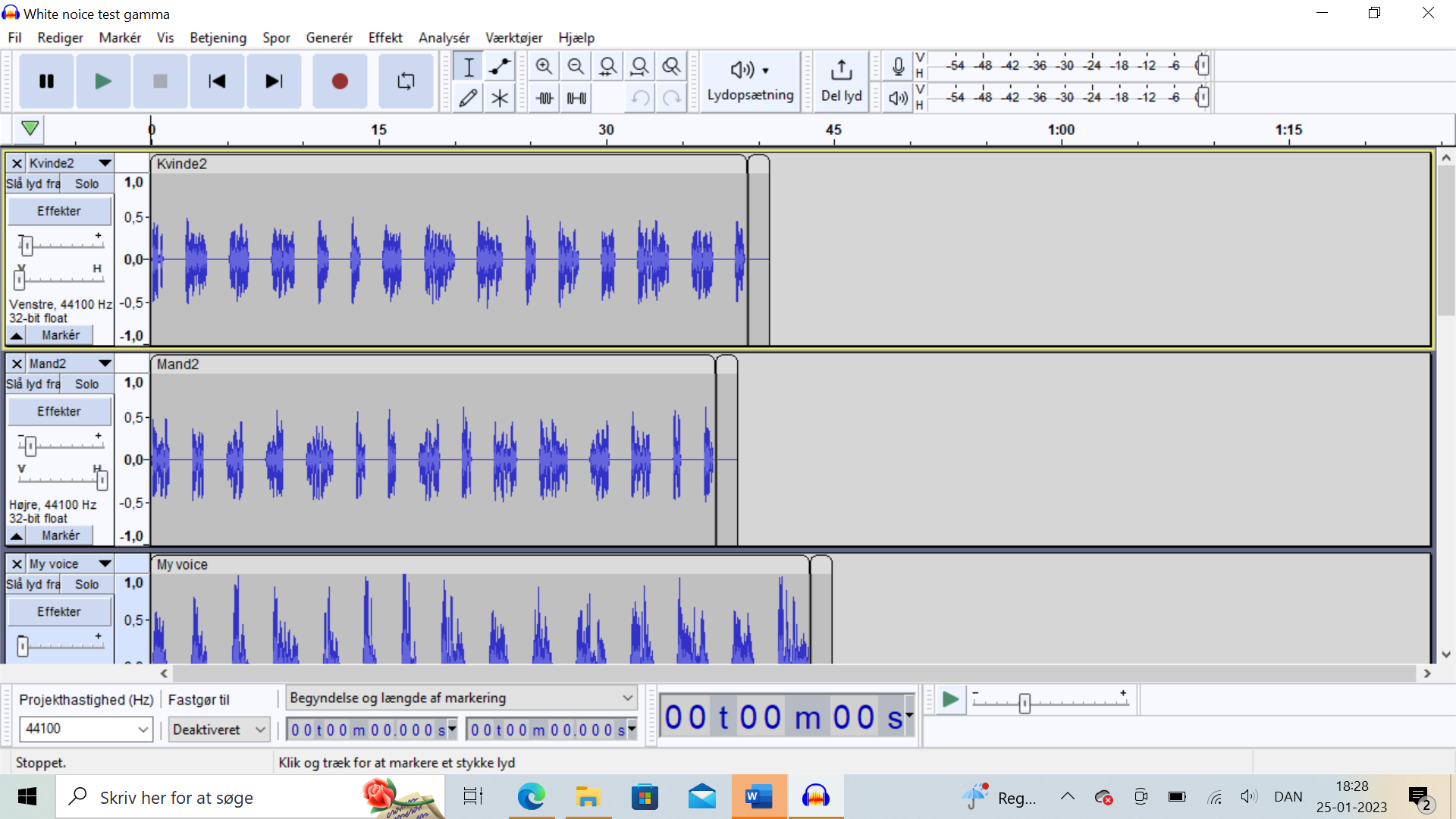

Another question.
I have 6 layers,
One white noice file from youtube as mp3m, 1 voice left (wav), one voice center (wav) and 1 voice right (wav).
And two layers with binaural beats.
Does the youtube mp3 white noice do anything to the file? It’s not changing the frequensy, just different voices.
Is there anything I should be aware of?
As you can see on the pictures, the waves are different and the volume is also different from word to word. Any way to make all the words the same volume?
Hope you understand.
Ohh this is the other picture
