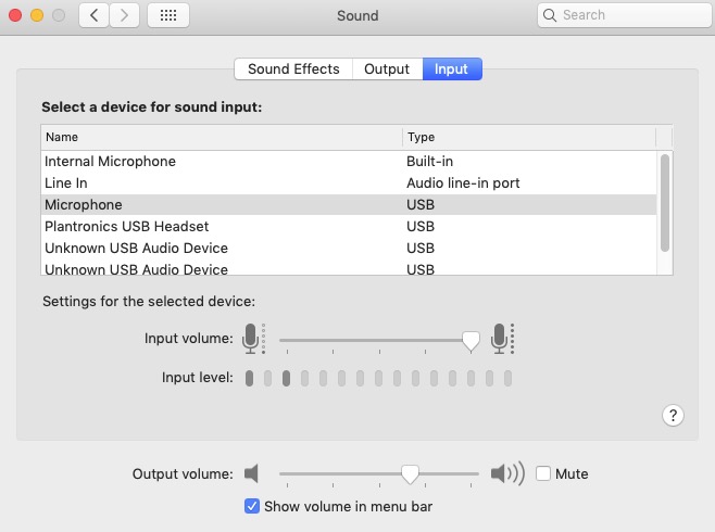

Is it still quiet in Apple (upper left) > System Preferences > Sound > Input?

yes, here’s what I see when I’m talking normally:
the other mics go all the way to the right of the bars.

I think the problem is that it is a quiet mic. Either you need a more sensitive mic for your voice, or a louder voice for the mic. Considering the amount of stuff that’s included, it was not a bad price, but the mic is one place that you really shouldn’t be cutting too many corners.
You seem to have a fairly quiet voice, so if you go with a USB mic, you really need one that has a gain control to give the signal a bit of boost.
