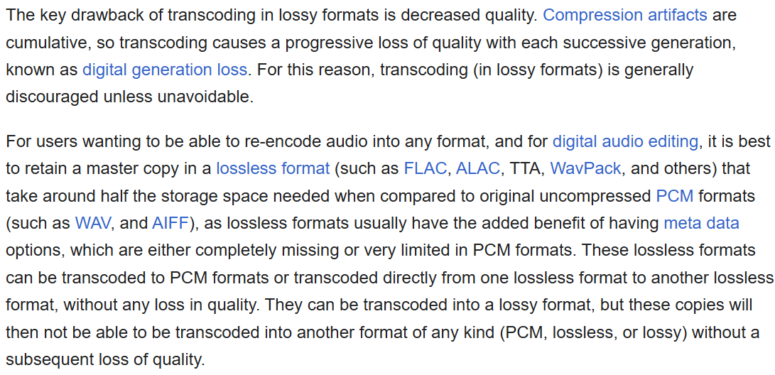

I don’t think this image answers my questions…but according to this, there is definitely an issue with generation-loss.
Meaning, if a maker uploads subject-matter, chances are - it already has lost information, then downloading again would make it like a pseudo-Version-3.

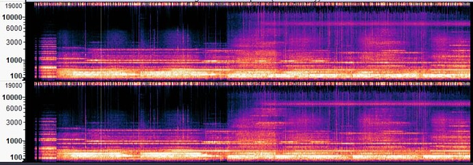

Okay, here are some images for spectrum analysis, granted these are photos and they do not resemble the actuality-of-observing-personally (IRL).
As you can see, the top image is the subliminal Internally Recorded, and bottom image - Downloaded Version.
I don’t know if I analyzed correctly…but here I go.
The sound perception is similar, meaning a person could theoretically listen to both versions and say “It’s the same thing.”, but I digress.
The Internal Recording is more data-concentrated with fullness, whereas the Downloaded Version is less data-concentrated with some kind information shift (plus lossage) as a result of compression. However, all ranges of frequencies are presumably compromised and massively affected (to whichever extent), when the two are compared. Each range is so different, it simply wouldn’t matter if one was pointed out.
The only artifact that may be present in the Internal Recording is the frequency-rate it is recorded in - as you can clearly see the colors on the image are brighter and more vibrant. What else could it be?
It appears as though the Internal Recording has very minimal artifacts added, if any, and minimal audio-information loss, if any, from website - resulting in a high quality feed.
Conclusion: I don’t know if the Internal Recording is as good as the targeted-subject-matter…but it might as well be. For the sake of conversation, you can casually determine (by all accords) which one is more powerful and feels stronger - just by looking at the two.
Any feedback welcome. :hugs:
Evidently the >15kHz magic has survived YouTube.
The louder the sound the brighter it is represented on the spectrogram.

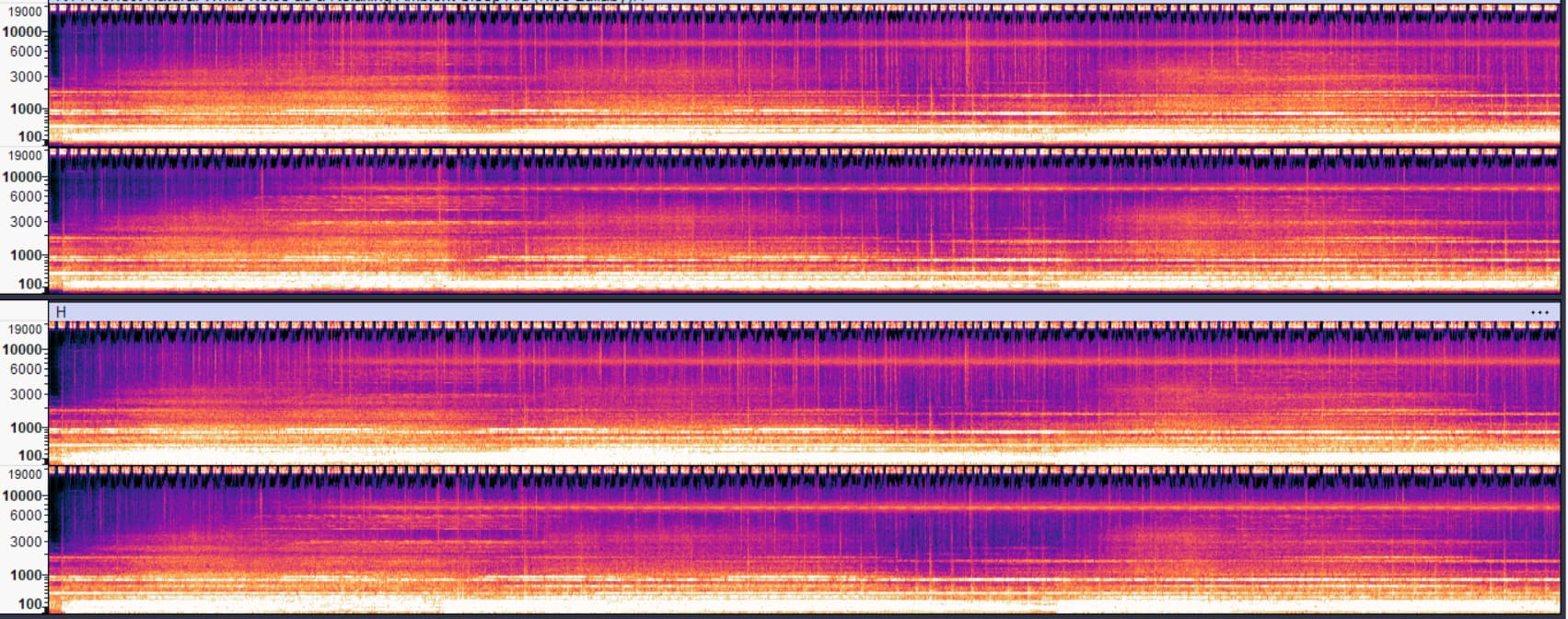

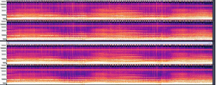

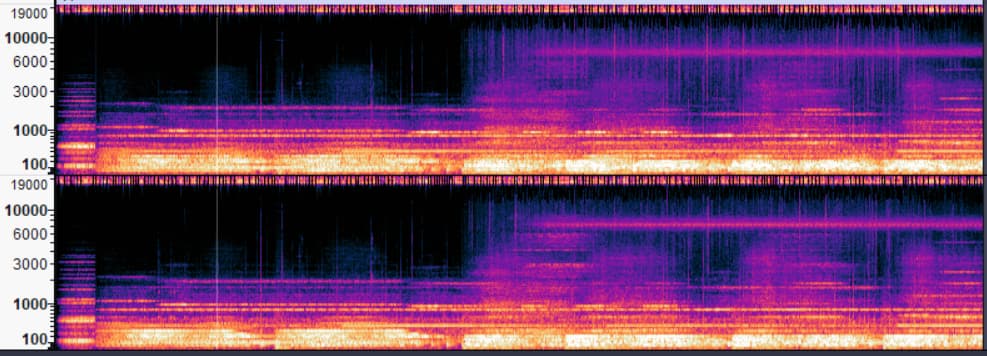

For a fair comparison apply loudness normalization to both before & after.
Again, Top is Internally Recorded and Bottom is Downloaded version.
Percieved Loudness normalization was applied as -4 LUFS, stereo channels independently, to both audio-versions.
Overall, loudness normalization did well to noticeably improve the Downloaded Version, whereas the Internal Recording remained the same.
Downloaded Version still displays significant changes comparing to Internal Recording.
Top images are more “cleaner” and sharper (still brighter), whereas the Bottom images are more dispersed and “blurry”, although previously - I referred to them as “data-concentrations”. This is a result of compression via transcoding methods.

Conclusion: The comparison, itself, is “more fair” after edits - even though my intention for the comparison was for them to remain untampered with.
Both comparisons still prove that - downloaded subs are compromised, unfortunately.
I was pleasantly surprised with improvements, however…the Internal Recording is still superior.
The signals in Top images are stronger and more present - which is what’s wanted from high quality sound.
A popular question may be “To what extent, are downloads not as potent?”;
Answer: Overall, depends on sound design. But, apparently it’s enough that sub results are affected.
