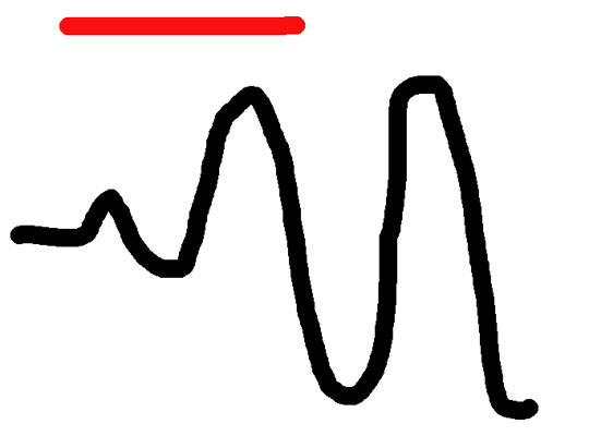

No. You’re fighting basic electronics. Pure silence is well-behaved and understood and pure sine waves are, too. However, starting a sine wave isn’t. Bad Graphic: sine wave starting.
Note the area under the red bar is not a pure sine. It’s massively distorted. Massive distortion creates multiple foreign tones, overtones and harmonics. It’s even worse if you manage to get a sine to start cold into a full wave from a dead stop. You can get award-winning damage by starting a sine wave somewhere other than the zero point.
That’s the trash you’re trying to get rid of. It’s a performer in your show and I don’t think you can stop it. The desperation method, other than re-doing the interview is cut and paste clean words into the hole made when you deleted the damage.

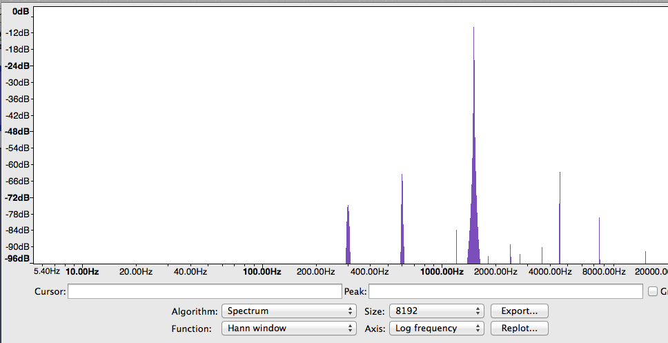

If you have a lot of time on your hands, you might try notches at odd and even harmonics of the base tone. That’s where most of the trash is going to live.
You might also try copy-pasting several trashes together into a longer sample and Analyze > Plot Spectrum. Use a very high analysis number and stretch the display sideways.
If you cursor over the spikes, the display will tell you the frequency.
