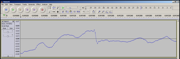

The crackle is due to skipping: intermittently tiny pieces (~1ms) are missing, (audio intermittently interrupted by another process on the computer), this usually causes discontinuity, which is the click/crackle …
There is a DeClicker plugin for Audacity which will repair the clicks, but it can’t put back the missing parts, so not a cure …
Ah I’ve had this problem before when accidently recording in 60FPS when my computer couldn’t handle it, a little weird it happened this time, nothing was strenuous, and it only screwed with my mic audio, not any of the others. Though I did record on a HDD I don’t usually record to, maybe that particular drive was too slow and had an issue a couple hours in.
I’ll give this a go, thanks.
