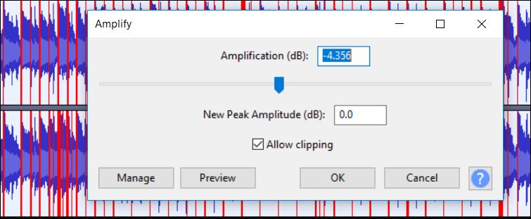

For example, if Amplify defaults to -2dB, your peaks are currently hitting +2dB and they are not clipped at 0dB.
Is -4.356 in screenshot above the “Amplify defaults” you mentioned? How/where can we find the dB# its peaks hit?

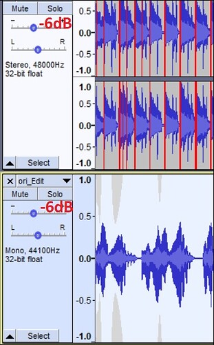

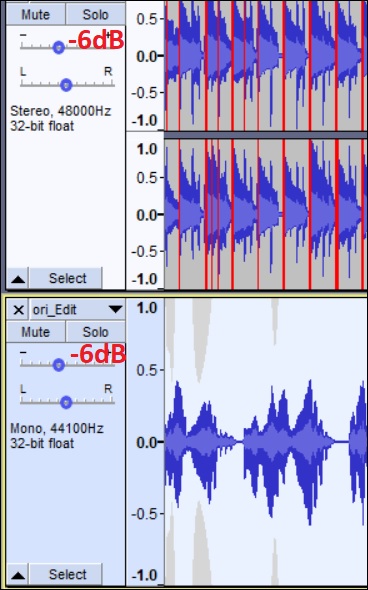

If you make a mix, mixing is done by summation so mixing can cause clipping. You can reduce the levels (to peak ta -6dB) before exporting
Do you mean to give -6dB to both accompaniment and solo in mix (see screenshot below) when exporting?
Your peaks are +4.356dB.
And, if you run Amplify again after attenuating by 6dB, it should default to +1.644dB (to bring the peaks to zero.)
Yes, both. -6dB is 50%. It depends on the peak of both files and how the peaks line-up. If both files peak at -6dB or less you are safe.
FYI - More advanced audio software* has a volume control and a meter for each track, plus a master volume control and master meter, similar to an analog mixer. But, it’s still hard to perfectly control the levels so it’s common to export to floating-point, or leave plenty of headroom, and then re-import the stereo mix for final “mastering”.

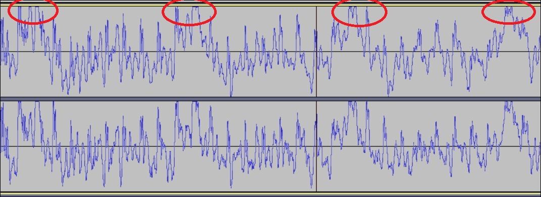

Try re-importing the WAV. Does it show (potential) clipping?
After re-importing the WAV, that “noise” section is as showed in screenshot below. Are those red circles “clippings”?
If so, run the Amplify or Normalize effect to bring-down the volume, then export as MP3
Since I’m not sure how to use Normalize effect, I simply turn down volume gain on left-side panel. Then the noise goes away if I play both tracks in Audacity. MP3 file does not have noise either :smiley:
