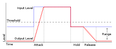

Noise-gates have hold times: they don’t close until the signal drops below threshold for a (used defined) period of time. If there is no “silence” for a (used defined) period of time the gate will never close: always held open.
