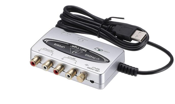

Unless the DELL input can be toggled* from mic-in to line-in,
Then you need a gadget to convert a USB socket into line-in socket(s).
e.g.
Don’t feed headphone/line-out into mic-in : the signal is waay to strong.
[ * I had a DELL laptop where that was possible ]
Yeah… Your computer has a combination headphone-out and microphone-in jack. The microphone input can “work” with a TRRS adapter, which has the extra microphone contact. But, it will be poor quality and mono.
