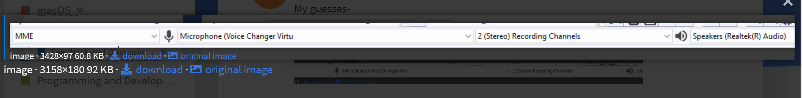

My guesses-
MME?, Microphone (Voice Ch Virtu), 2 stereo recording channels, Speakers (Realtek Audio)
So you if you use MME, you will have t find a device “StereoMix” or similar. Many computers do not have this.
You are left with using HOST: WASAPI, recording device “Speakers (loopback)”

No I never said that. Actually, with Host set to WASAPI, and Recording device set to “Speakers (loopback)”, you will want to select channels as 2 (stereo).
The current version is 3.3.3, which you can download from here: Audacity ® | Downloads. So you are right. Audacity 3.2 saw the introduction of the Audio Setup button, which hides those things I think you are talking about. Even so, I don’t think you need to set anything for your Playback device, as it is not being used in this situation, at least not until you start to play something back.

To be clear,
change MME to “WASAPI”
change your microphone to “Speakers (loopback)”
set your channels to “2 (stereo)”
keep your playback device at “Speakers”
