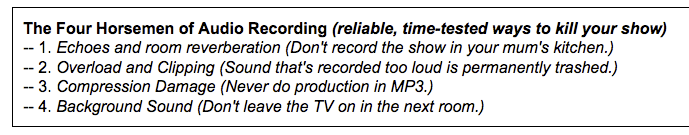

Echoes are killer difficult. They’re one of the four horsemen or ways to reliably kill your show.
#1.
Screen Shot 2023-08-14 at 8.07.31 PM
