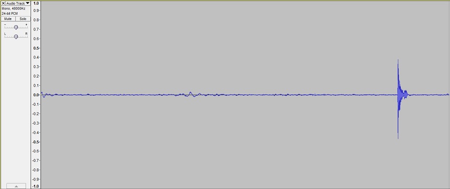

Hi,
I recently appear to have been getting this issue (As seen in the attachment below), I’m not exactly sure what is causing this & it appears to happen at random intervals but i can’t quite pinpoint the issue, just to be clear I know it is not the device I am using to record as i got it brand new out of the box this morning. The weirdest thing about this issue is it sounds no different to any of the other noise in the clip although because I use noise removal it mostly severely deteriorates the audio quality of the track.
The version of Windows I’m using is 8.1 & Audacity version is 2.0.6 (Tried with 2.1.1 but unfortunately the problem persists).

What does your screenshot represent? Is it noise between words or songs, and is that before or after noise removal? And is the peak in the screenshot some unwanted random noise like a click? If so, how often do those random noises occur?

The screenshot was supposed to represent the random waveforms that occur at the very start of the clip & about 5 or so seconds into the clip with nothing to make them occur although I realise now that a screenshot does not clearly illustrate that.

As weird as this may sound I think the underlying cause of the issue is due to vibration that the microphone is somehow picking up.
As an example I recorded a 10 second sample of “Total” silence which when listened to shows no audible disruption etc, however there is clearly something causing the waveforms to become so erratic.

I agree the waveforms of the noise are a little more jagged than might be expected but you only have two fairly quiet clicks embedded in the noise either side of 7 seconds - if this had been the noise you had before it should have caused less problem for Noise Reduction.
The noise profile should not include any embedded clicks. Try zooming in a little and select a noise area for the profile that looks flat and centered over the 0.0 line.

Upon further investigation I have realised that the waveforms only seem to be that way if I’m recording directly from my computer, I did the same test recording but instead using my phone & imported the audio file to Audacity & the waveform was completely flat, not jagged & erratic as has been shown in previous posts.

From what I see in this latest picture, I would recommand a highpass filter at perhaps 60 Hz and 12 db/Octave or more, to remove low frequency vibrations.
Clicks can be seen, not just heard, if you use Spectrogram view. They appear as vertical streaks.
Indeed though those clicks are more like a soft beep. They are barely visible even after noise reduction (I think they are a little hump of blue).

The problem was not the clicks as i believe those were actually caused by my mouse, the problem was the fact the waveform was going rather hectic considering there was nothing i thought to be causing it, turns out the waveform turned out that way due to low frequency vibrations & using a high pass filter as you suggested fixed the issue.
