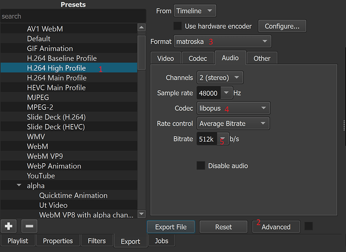

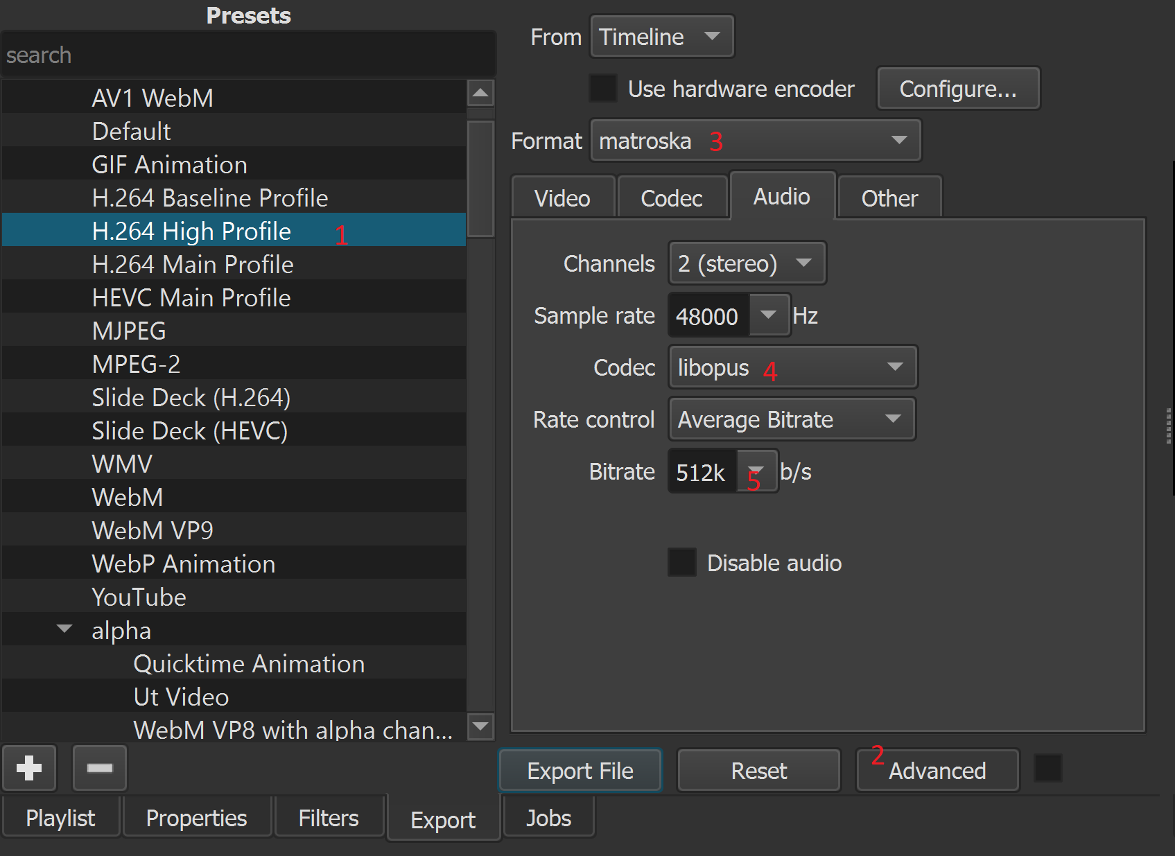

I use Shotcut to edit my video files. I know (and have done so in the past) I can add the de-noised audio file from Audacity to replace the original audio track. Doing it that way, I have to (or at least I do) re-encode the video file. I guess I was thinking I should maybe convert the wav file to something smaller (say aac) before I add the audio back to the video file in Shotcut. But then I thought about syncing things up and that might be a problem if I converted the wav to a compressed file.
Shotcut doesn’t seem to have a way of setting the audio quality. Perhaps I have misunderstood what the video editor (Shotcut in my case) does when encoding to mp4. It seems if I look at the video I created with the wav audio in VLC, the audio track is aac. So perhaps my ignorance has caused me to ask a question that is completely immaterial.

You’d just be unnecessarily adding compression artifacts: AAC is a lossy format. Just import the WAV into the video editor.
I’ve never used Shotcut, but apparently it does have quality settings …
