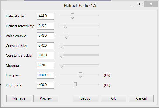

I would just experiment… AM radio goes from about 50Hz to 5kHz… But some radios will limit it more. When you limit the high frequencies you reduce the “T” and “S” and that hurts intelligibility.
Some distortion may also help with that old-time sound. the Limiter has a setting for Hard Clipping. and there are other Distortion effects. Clipping is the most common kind of distortion… You get clipping when it you try to get 11 Watts from a 10W amplifier, etc. It can also add “grit” to voice.
AM radio usually also has noise in the background (hiss and/or hum, etc.). You can use the Generate → Noise tool to generate a couple kinds of noise and mix that in, if you like the effect.
There is a free plugin which does that: “Helmet Radio 1.5” …

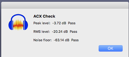

I applied the simple Audiobook Mastering Macro and it passes all three ACX sound specifications.
NoNoiseReduction2023-07-21
The background noise “passes…” but is a little too loud. You should hit noise at least -65dB or quieter. I applied the noise reduction of the beast (6,6,6).

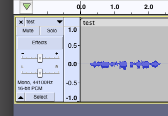

Your posted WAV file is slightly low volume.
Screen Shot 2023-07-21 at 4.11.17 PM
The strongest tips of the blue waves should come in around 0.5 or slightly quieter. That’s -6dB to -9dB on the bouncing sound meter.

Also highly recommended is ACX-Check. That checks the technical quality of your work a lot like the ACX Audiolab tools do.
https://www.acx.com/audiolab
Except we also check noise and they don’t.
